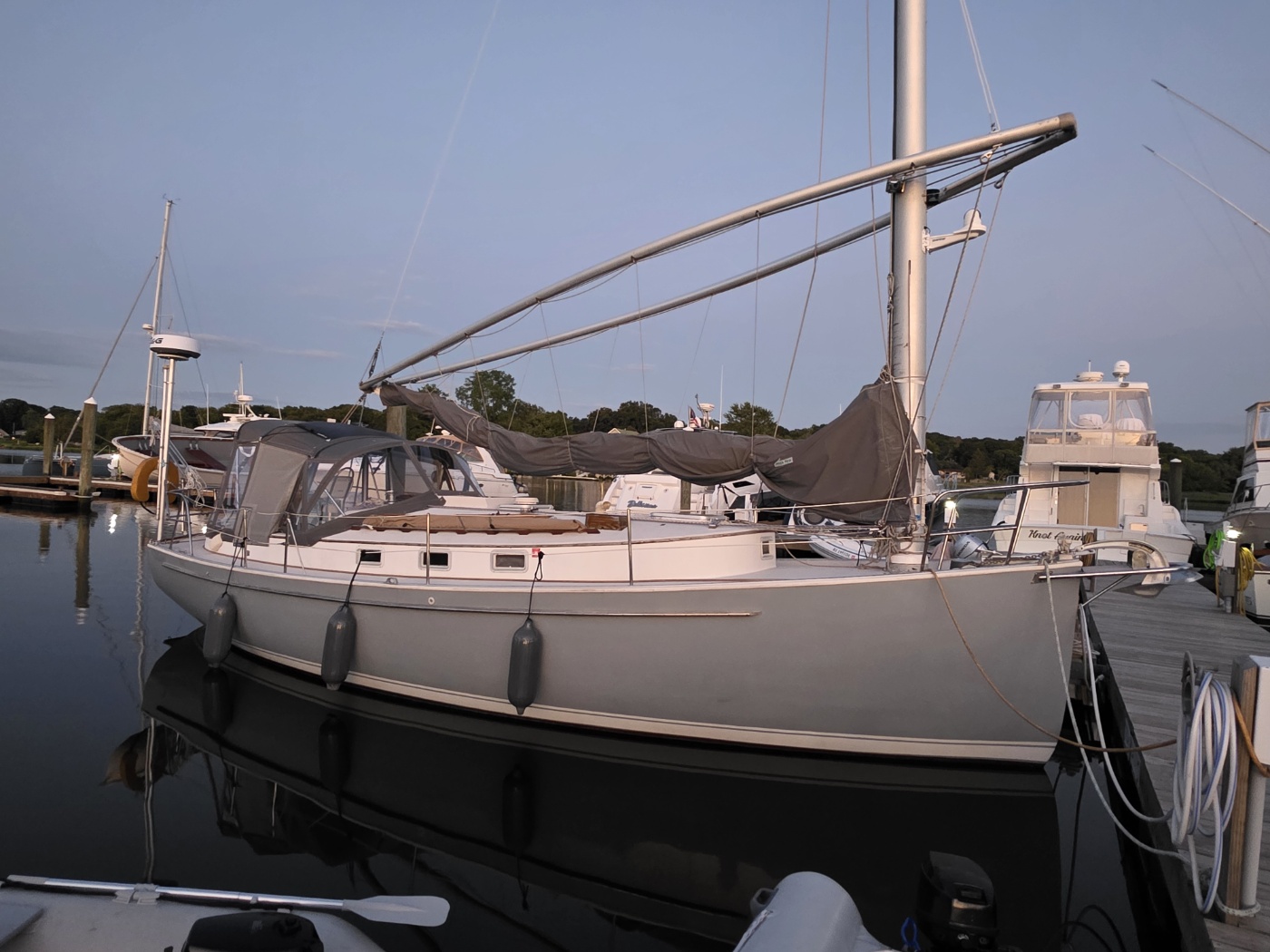

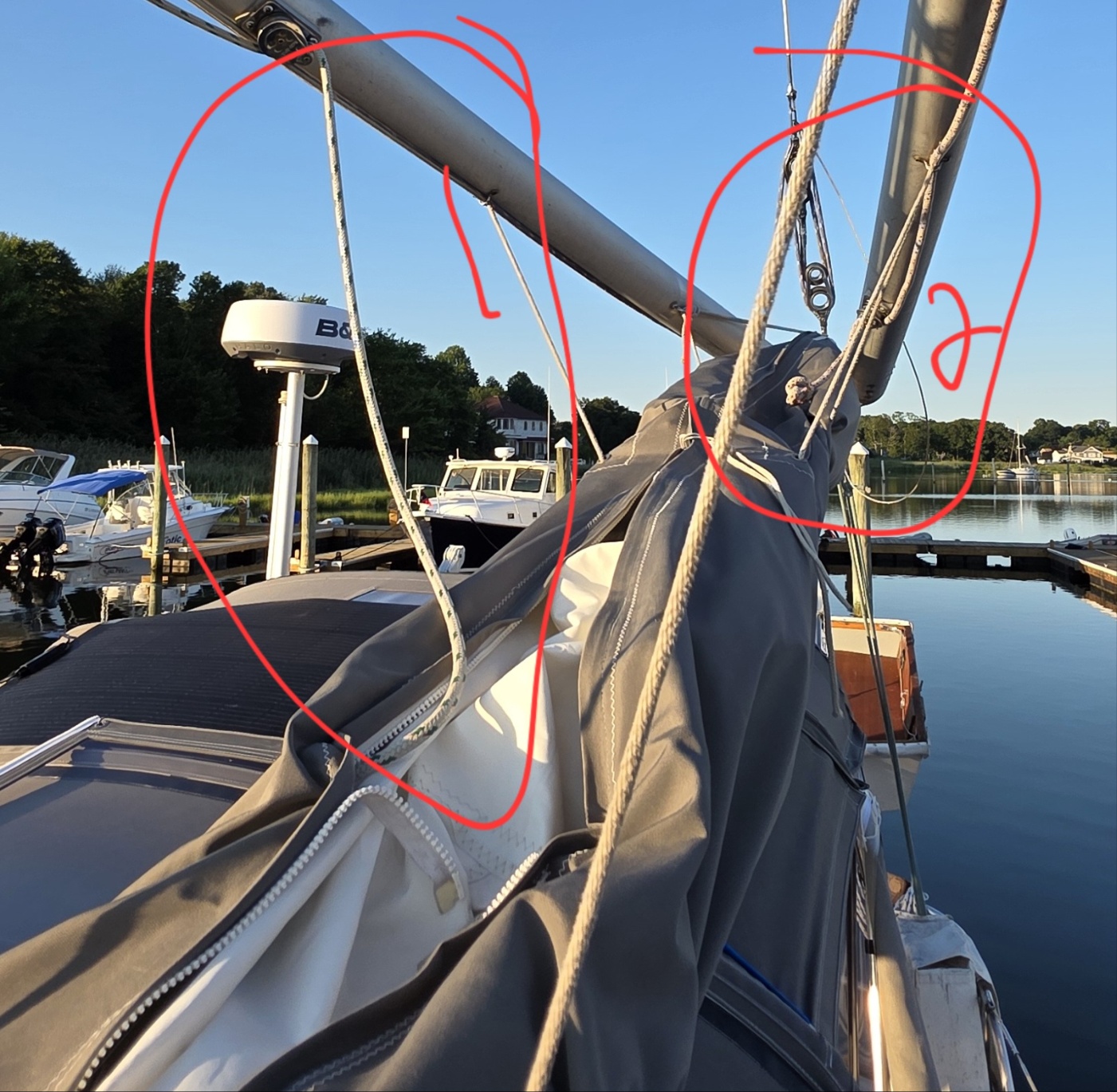

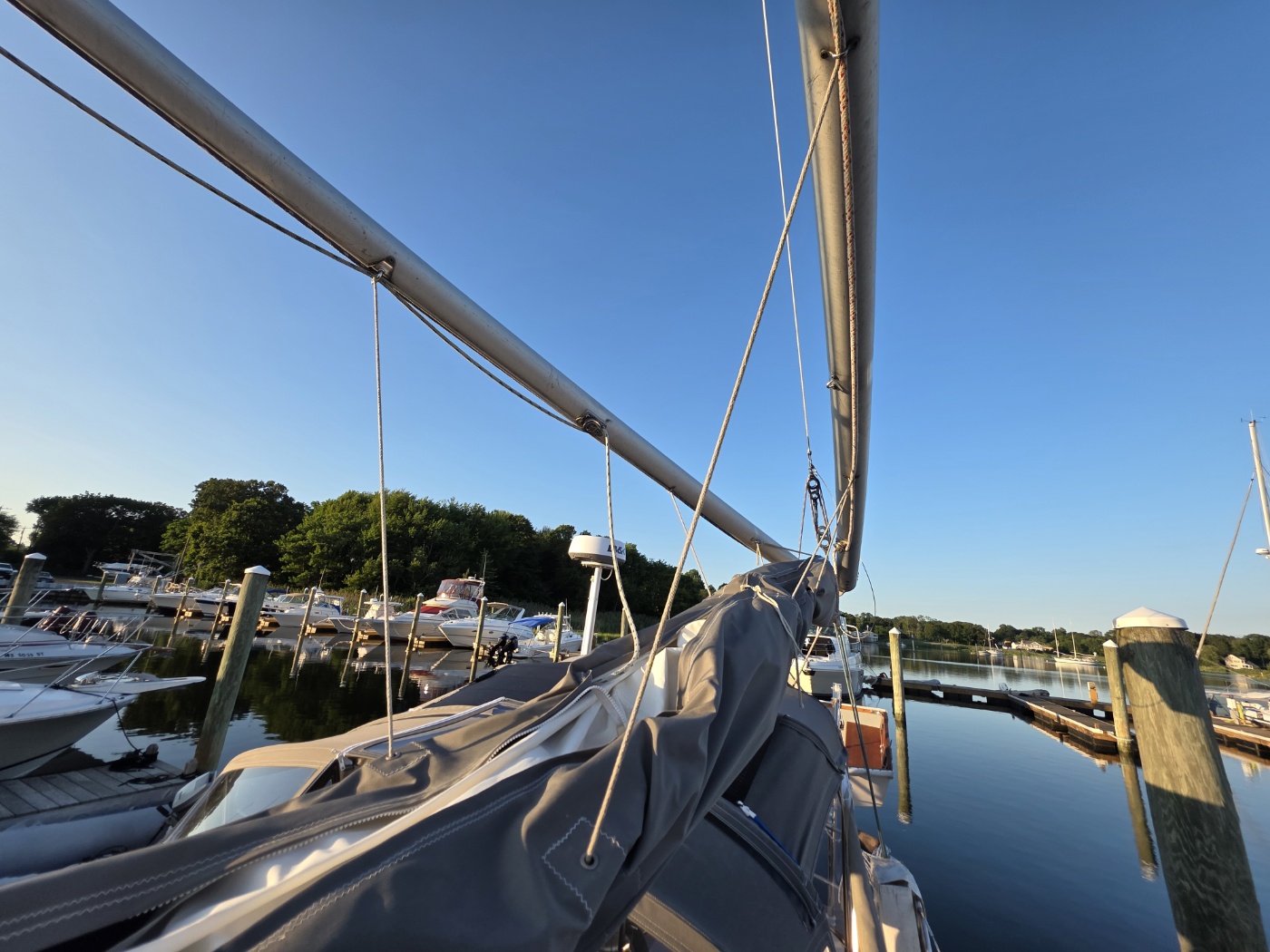

Anyone available for a day sale on my NSU30 out of the Bay Marina in Warwick Cove this or next week? Looking for someone that is familiar with reconnecting the reefing lines to my sail. I believe one is on already, #2 has a knot on the aft end, see photos. I took the sail off last fall for cleaning.
The weather is looking real good for the next several days, I can be ready to head out around 2PM on Wednesday, Friday or Monday July 28th, busy Thursday and Saturday. Thanks!

The line marked 2 in your photo is the 1st aft or clue reef line it goes from the pulley it’s on thru the first aft cringle and is tied on the other side. Mine goes once around the opposite wish boom and tied to the same loop as your cover support line. The line marked 1 is your second aft reef line. It is run from the pulley thru the second aft cringle and ties in a similar fashion around the opposite wish boom. Hope this helps.
