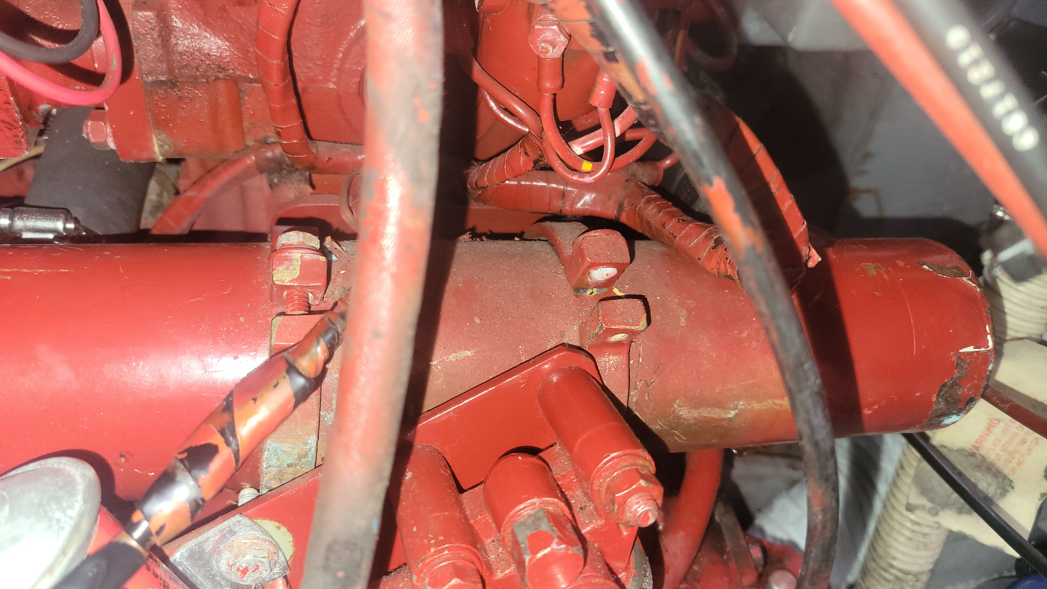

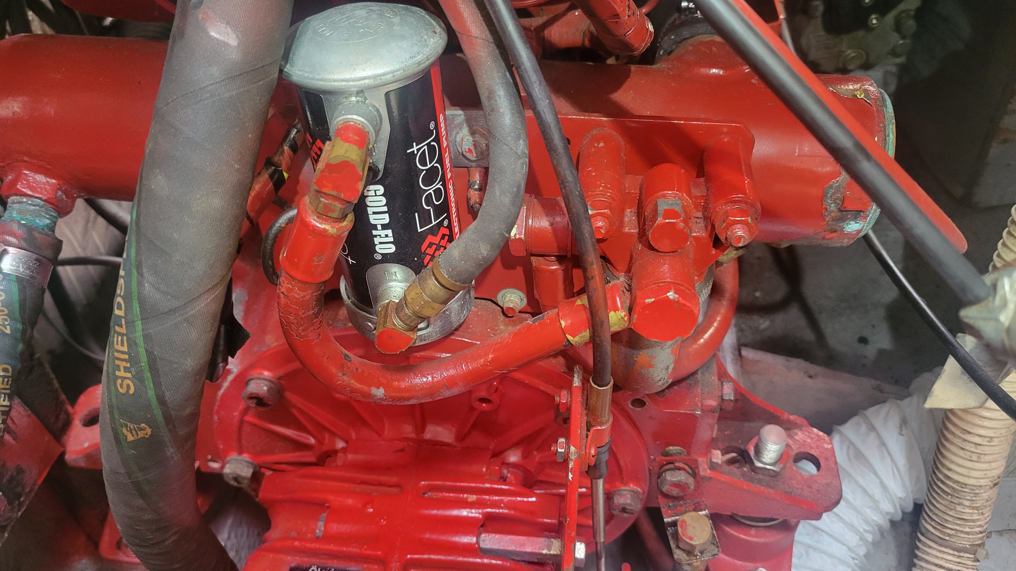

Here are a few photos of the old exchanger coming out, and the new one going in:
Had to move (but left all connections in place) the fuel pump (black cylinder w writing) to get to the heat exchanger - luckily, not difficult

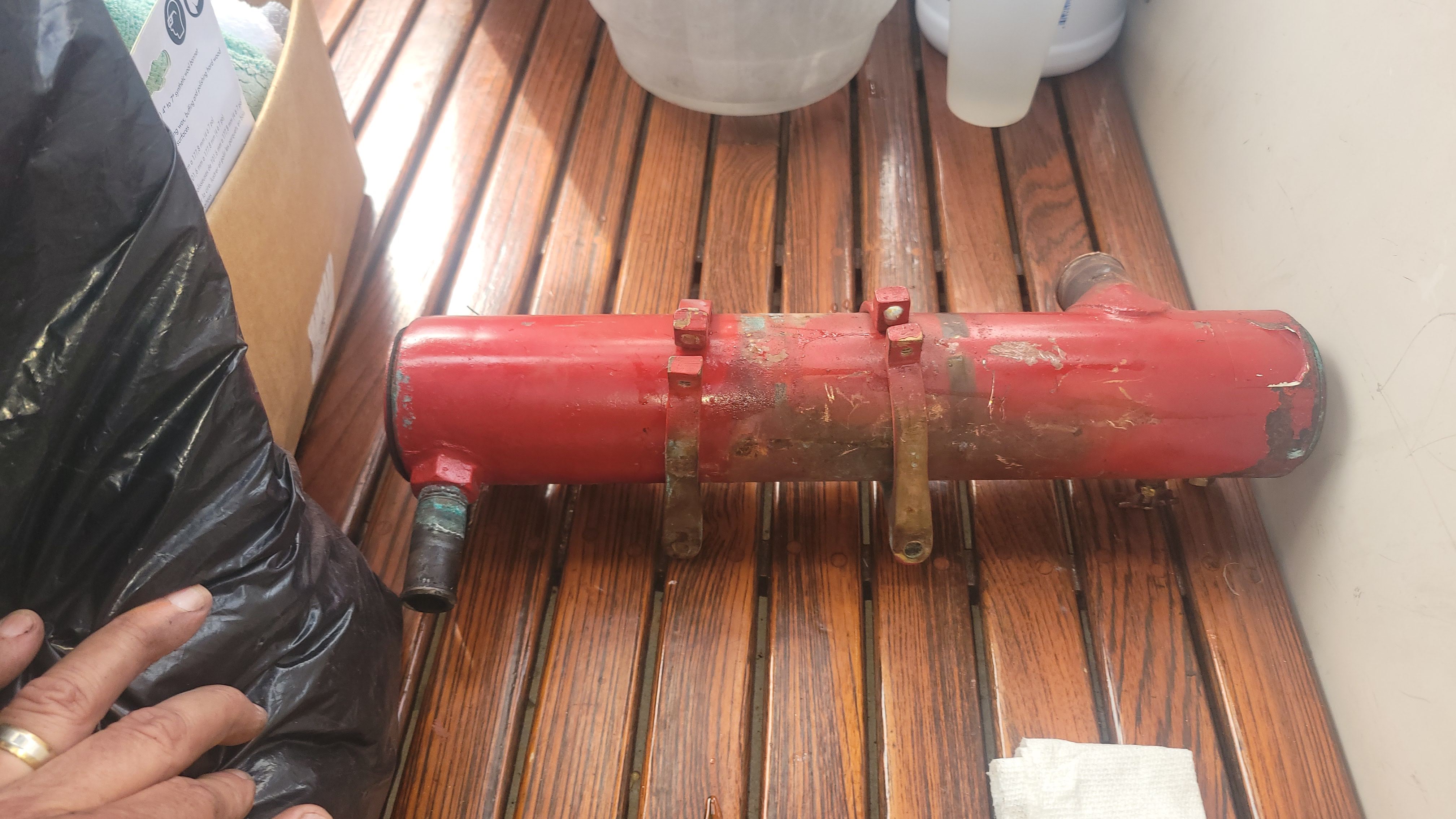

The original heat exchanger brackets - 1 with 1 without the bolt in place.

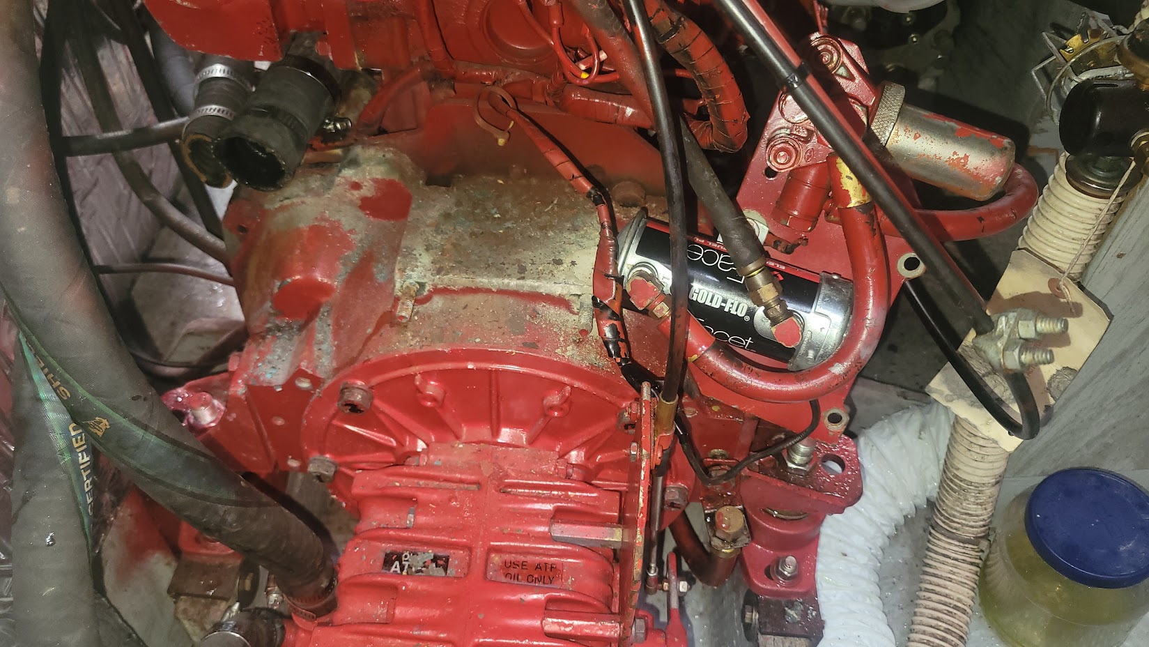

Old exchanger removed
Old exchanger out! Couldn’t get the old tailpipe (left side facing camera) to budge… glad I ordered a new one!

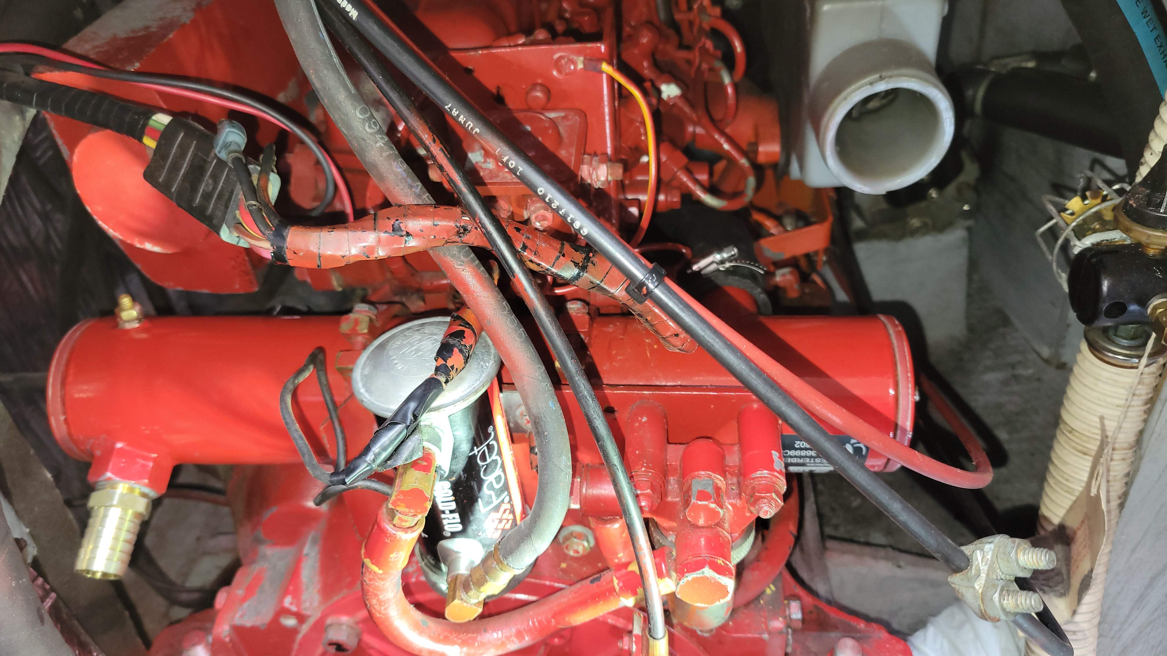

New exchanger in place with hoses reattached (except for new tailpipe (left side) hose that goes to the
transmission oil cooler - did that after this photo was shot), Fuel pump et all re-mounted.
