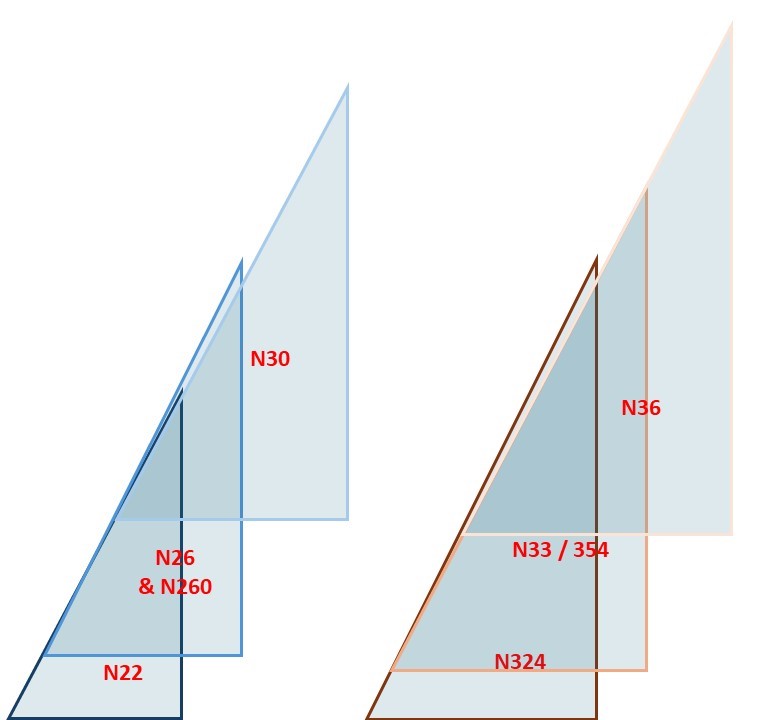

First, the wishbone angle is NOT the same across the different models. You need to compare yours to other 26’s rather than to a 30. I don’t know what the ideal wishbone angle is, but my understanding is that it’s sensitive to the aspect ratio of the sail (how vertically pointy it is, if you will).
This drawing gives you a feel for how that varies across the models. If they all had the same aspect ratio, the hypotenuses of these triangles would be perfectly aligned. Instead, N26s and N260s have a higher aspect ratio than their next smaller or larger peers, while an N324 has a slightly higher aspect ratio than its larger peers.

For some reason, I don’t think the drawing I tried to post illustrating the difference in aspect ratios made it through.
Here’s a second try:
If they all had the same aspect ratio, the hypotenuses of these triangles would be perfectly aligned. Instead, N26s and N260s have a higher aspect ratio than their next smaller or larger peers, while a N324 has a slightly higher aspect ratio than its larger peers.
