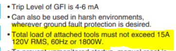

I have exchanged some emails with Marinco tech support. While the male end of the pigtail is a 30 amp rated connector, the conductors in the cabling are only 12 gauge which is inadequate to pass 30 amps continuously without overheating. In addition, the triple female connector is only rated at 15 amps - not per socket, but apparently for the whole subassembly. So they only rate this pigtail at 15 amps. And there is no 15 amp circuit breaker or fuse, only the GFCI.
It is legal. (Consider an example: you can plug a 16 gauge extension cord - which is really only good for about 8 amps continuous load - into a 20 amp circuit and it is your responsibility not to overload the cord.) But it is not very practical. You sure don’t get much for the high cost of the cord and the pigtail. And I think putting a triple socket on it was a really bad idea on their part. A shop vac and a sander would exceed the rating of the cable, but not blow the 30 amp breaker. A heater should probably not be run with anything else. Attention will always need to be paid to the current draw by anything that gets plugged into it. I think this gives more credence to Bob’s concerns about things potentially going wrong after time passes and attention shifts to other things. If you do it, you’ll always have to pay attention to how much load you are putting through the 15 amp rated components.

As for the pigtail we’ve been talking about, since it is deceivingly inadequate for the three 120V plugs it offers, I think it would be better to use one of their plain pigtails with a single 120V plug and supplement that with a GFCI adapter such as this: https://www.homedepot.com/p/Yellow-Jacket-1-Outlet-GFCI-Extension-Cord-Adapter-2762/204667709 I use one just like that (only yellow) with my tile saw and it does pop occasionally when a lot of silty water starts flying around. So I know it works. Just be sure to never leave these extension cord setups unattended.
