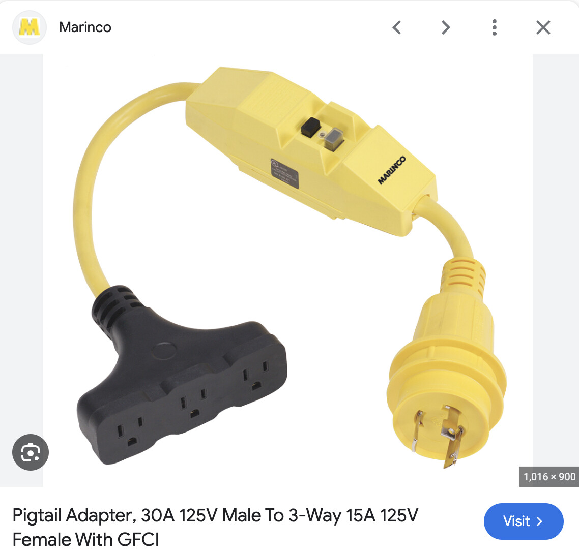

My 1982 Nonsuch 26 ‘Inner Peace’ doesn’t have a shore power inlet, and it seems like this version of the boat was designed without it. I’m planning some winter projects on my boat.
How many of you in the group have installed a shore power inlet?
Since I’ll only be on the boat for a few hours, I’m considering not putting in the effort to install a shore power inlet and AC panel. Instead, I’m thinking of using a pigtail adapter from Marinco to run a heater and charge the batteries with a battery charger. Whenever I leave the boat, I’ll disconnect the pigtail adapter and return the shore power cord to the dock.
I understand that I shouldn’t leave this temporary shore power setup on my boat continuously. The pigtail adapter comes with a GFCI circuit breaker. Do you think this setup is sufficient, or should I still consider installing a permanent shore power system?
I don’t live on the boat, and I’ll probably spend a maximum of 4 to 6 hours a week on it during the winter.

I assume, Siva, that the item shown would be on the inside of your boat? In that case, you would still need a 30 amp cord from the pedestal to the inside.
![CleanShot%202024-12-03%20at%2006.20.22@2x.jpg|1138x1092](upload://5i23AY5BdaxoSv2hcwrW3i4MvWC.jpeg)
Or plug the adapter shown in to the post and run a 15amp extension to the boat.

Your plan seems fine to me. It’s no different than what contractors do at building sites all the time. And GFCI protection is really important near the water. Especially salt water.
You might want to ask your marina if the dock power is already GFCI protected. I think I read that it is the current code, but was recently added. Also, states and cities can and do adapt the national code to their own jurisdictions. So some jurisdictions may require marinas to be retrofitted with GFCI breakers and others may not. (If the marina does have GCCI breakers, you might ask if they can test yours.) If you have a functioning GFCI breaker, then you won’t need the one on the pigtail which will save you money and it will be less clunky.
This pigtail is outdoor rated, but you are right not to trust it while you are away. For example, don’t count on it to keep a heater running in your boat over the winter. It only takes a few milliamps of current to pop the GFCI breaker and then you’ve got no heat. A little salt mist washed down into the contacts could be enough to pass such a small current. I have a similar inline GFCI pigtail that I use with my tile saw and it pops from time to time just due to fresh water intrusion (probably contaminated with minerals from the sawing.)
Finally, there’s a practical question. What gauge wire is used in the pigtail cabling? A 30 amp breaker will trip with a 24 amp (80%) sustained load. And the GFCI breaker is not a load current sensing breaker, it’s just for leakage to ground (possibly through you.) So if the wire in the cabling is 10 gauge, then you can safely run three 8A or two 12A devices at once without tripping the breaker on the dock. (Total of 24 amps.) If the wire is only 12 gauge, then you need to limit your total draw to 20 amps because that’s the maximum that you should pass through 12 gauge wire.
I looked on the Marinco website and they failed to provide much useful technical information about their product. But the gauge might be printed on the cable sheathing. Or it might say on the packaging. Or you could contact them. Without knowing the wire gauge, I’d say you should limit your total draw to 20 amps.
The problem with the simple extension cord is that, besides not being waterproof, may not meet the requirements of the marina.

The standard Marinco cords really are just specialized extension cords. One difference from regular extension cords is the heavy insulation. It is hard to damage them and you really don’t want exposed wires near the water.
They also have 10 gauge conductors. You can get “regular” extension cords with 10 gauge conductors from Home Depot, Lowe’s, probably other places, but with lower quality insulation. They are still expensive compared to the cheapo 12 and 14 gauge cords, so it makes more sense to just get the right cord in the first place.
Marinco cords don’t use tinned conductors. That’s a bummer, but if you are going to buy a new one and don’t mess around changing plugs, it will be fine for years. SmartPlug uses tinned conductors, which is much better and safer, but they don’t seem to supply the adapter that you need.

Actually, my agreement with his plan assumed he was using a Marinco cordset and putting the pigtail on the boat end, just as he has described it.

I’d encourage you to install a proper marine-grade power system.
We all plan to be really careful, e.g., roll things up and make sure they don’t get wet. But then life happens, and it’s dark, and we’re late, and we gotta get home, and the plan to, “… disconnect the pigtail, roll up the power cord, and hang it back at the dock,” doesn’t happen.
And salty, humid air and other things will start corroding the uncovered ends of that hanging cord before you know it – even if you are as good as you intend to be. I personally don’t want anything electrical sitting exposed out in the environment any longer than absolutely necessary, and certainly not for the 162-164 hours a week you’re proposing to let it hang back at the dock. There’s a reason the marine systems have waterproof covers at both ends.
If you are going to cut corners anyway, I suggest at least reading this article: https://www.practical-sailor.com/systems-propulsion/electrical/ensuring-safe-shorepower.
WHATEVER YOU DO, INSPECT IT REGULARLY. I nearly had a fire on one of my boats with a far safer and more standard set-up then you have in mind.
And check whether your insurance will actually cover you for an electrical accident caused by a non-marine-grade installation. And that you’re insured for damage to the marina, other boats, and other people.
If all goes well, then all will go well. If not, not – and in that case don’t be surprised if your insurance company doesn’t return your phone calls.

Contractors use setups like Siva is proposing all the time and marine techs (mechanics, boatwrights) used to use them before decent battery tools became available.
But Bob is 100% correct that you need to use them responsibly, take care of them, and never get lazy. And I know nothing of the insurance ramifications.
I was considering suggesting the addition of a permanent installation, but to do it right would require time, planning, and money. I don’t know Siva, but I do know that the boat is still new to him and so one or more of those things is probably in short supply. I know I’ve had my boat for a year and a half and there are still things undone that I really should be taking care of.
If you do decide to go permanent, Siva, then you should take a look at the Smart Plug system instead of Marinco. They use tinned conductors in their cables which is a huge safety factor. And I get the impression that they seal better, though it might be just marketing jive. They are also easier for someone who is unaccustomed to the boat to plug in - a problem I’ve experienced with helpful guests.
