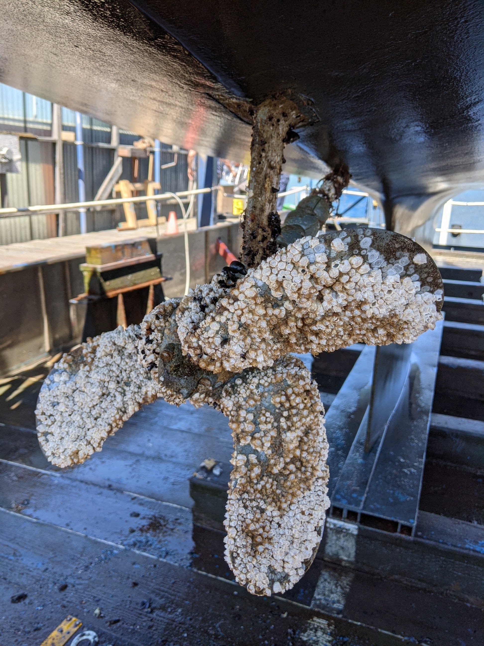

I had somewhat similar problem with propeller covered in barnacles before having boat lifted for spring cleaning. Couldn’t get above 1500 rpm.
Second choice would be your fuel pump is failing.
