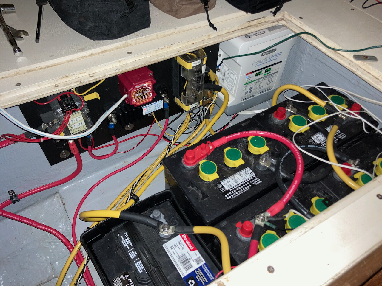

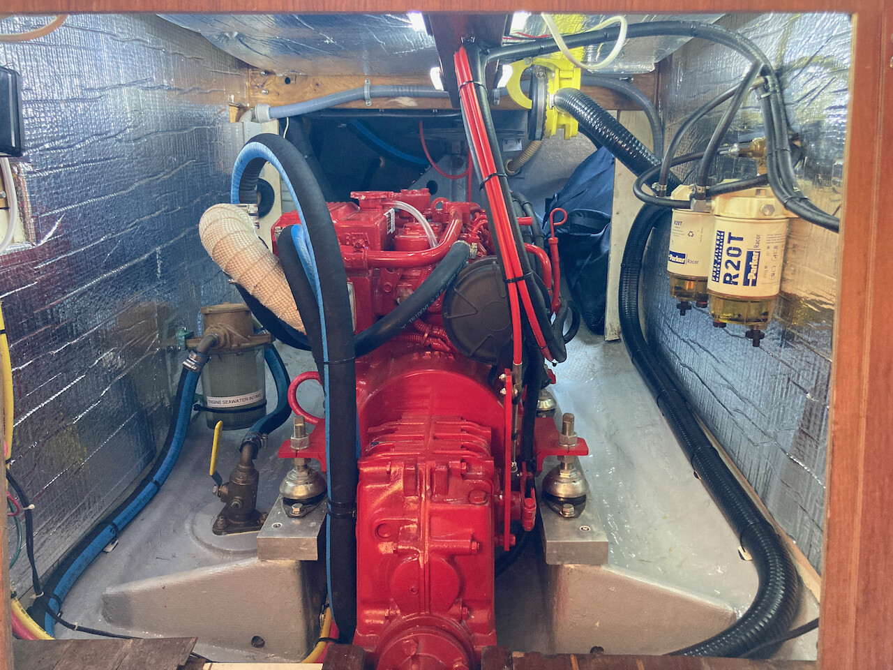

We are on our first season with an Airhead so I won’t offer an opinion on the utility - although I’m confident I won’t regret it - install was straightforward enough. RE: how we used the space where the holding tank was. I moved all the engine bay wiring, charger and batteries into that space to be easier to access, create more room in the engine bay and make battery maintenance less of a chore. If we start cruising again, I would put a water maker in there. We have a NS30C where this was all under the main berth but hard to access. Those less easily accessed lockers are now available for general storage items, tools etc.

Very nicely done. Thanks for the pics. Will contemplate that for next season.
I am looking for new engine insulation and really like what I see in the photos.
Do you remember where you got yours?
