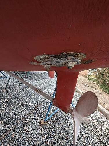

I have two external anodes on my boat :
  1. A shaft anode. Which is easy to have on hand if you know the diameter of your shaft.
  2. A hull anode, which I’ve been told is uncommon for fiberglass sailboats. I suppose you could determine if you have one by following your bonding wires from the inside. In my case there are two metal studs visible from the inside with the bonding wire attached to one of them. The anode you need for replacing will have holes that line up with the bolt spacing. Picture for clarity… showing depleted shaft and hull anodes on my boat before I replaced them.
  3. Internal anodes for things that have seawater flowing through them like heat exchangers.
    Both hull and shaft anodes are replaceable without pulling the boat. A diver might not charge as much as a yard would charge for a short haul.

Re: anodes, I keep two 1" oval zinc anodes on the prop shaft (replace each year). We also have a zinc pad that is affixed to the hull much like the photos posted by others. I think that one is tied into the bonding wire system. It doesn’t seem to degrade much year-to-year. I think the shaft zincs may take the brunt. However, re: the pad, it’s important to make sure your wiring is all connected properly (although even if it isn’t, you should be fine as long as you stay on top of the shaft anodes). When you apply the shaft anodes, remember to hammer them on so the pins make firm contact with the shaft. I’ve found it seems to help to paint the screws/seam line with bottom paint, but who knows how much that makes a difference.

The use of zincs with through-hull bolting looks wrong. First, it is causing hull resistance; 2nd the setup can fail and sink the boat; 3rd, I have not seen any of the Nonsuchs’ in the Connecticut River valley/LI Sound with such a setup.
Joe Carroll, Madaket, Nonsuch 30 #56.
Hi Joe,
SOAVE was purchased in Oct 2023 on LIS with this setup. I guess she flew under your radar.
I agree a hull anode is unusual and has some drawbacks… I suppose every boat has a few things that others would consider to be done wrong. I see this as room for improvement, but OK for now.
This year when I replaced it I mounted an aluminum replacement anode flush with a rubber pad between the anode and hull. Slightly less drag and less interaction with my bottom paint. The likelihood of failure that would sink the boat is actually pretty remote compared to my other thru-hull fittings. I also have a grounding plate that needs to go… it is unlikely I’ll use SSB radio now that we have SATCOMs.
I don’t know who installed the hull anode or why but I have a few theories. I suspect it was installed to address unusually rapid corrosion… a better approach may have been to identify the root cause of the rapid corrosion and address it directly.
Maybe the moral of this story will be to add an isolation transformer or galvanic isolator before you add a hull anode. This might be food for thought for other owners.
Once I get a handle on why I’m seeing rapid anode depletion… ( i.e. install galvanic isolator ). I’ll remove the hull anode and repair the holes.
