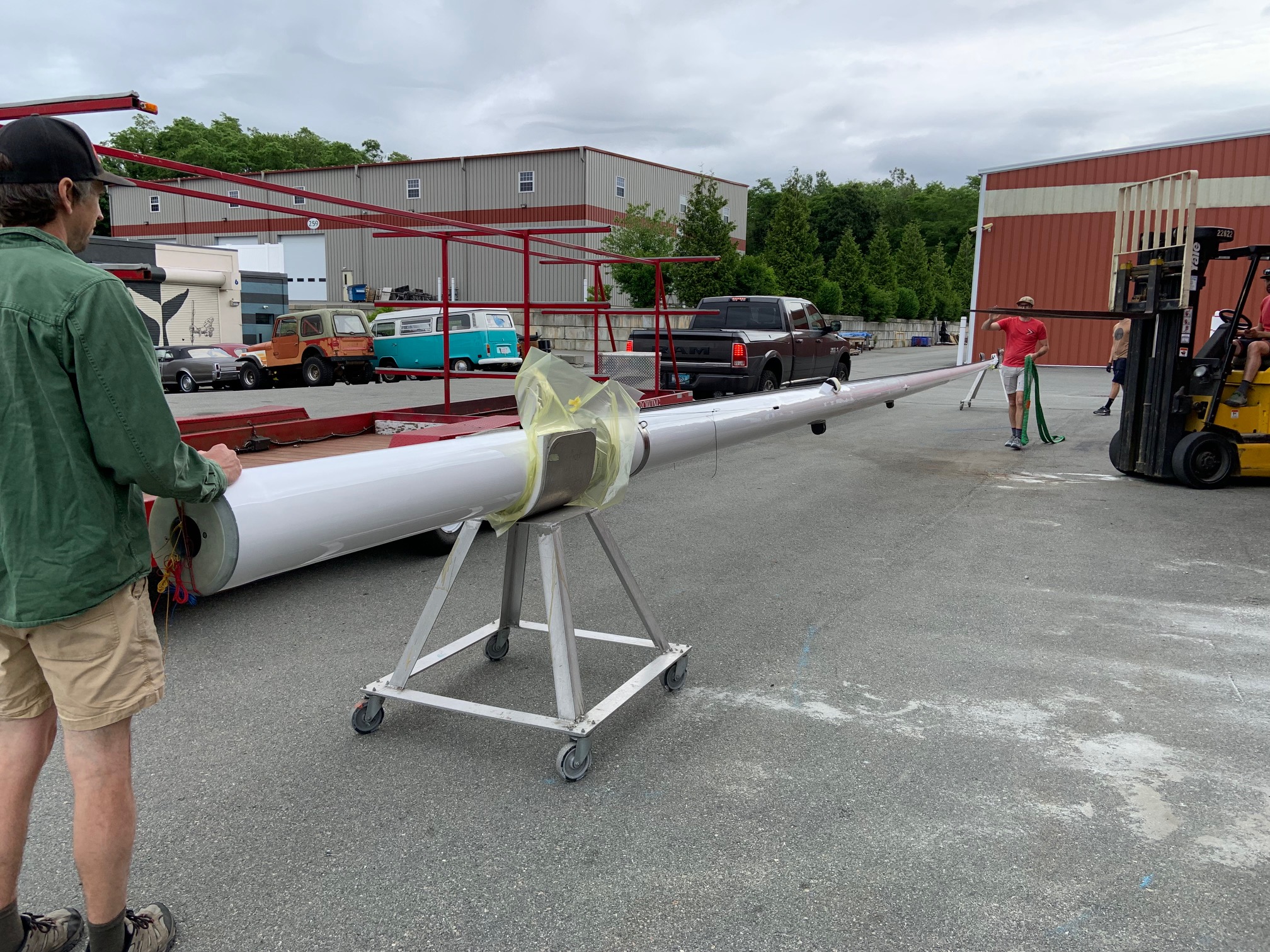

I sent the report, photos and estimate for a new carbon fiber mast to my insurance company by email. They replied “okay” 1/2 hours later.
It took over 8 months to get the replacement mast as the designer/builder was transferring the equipment from his place in Concord, MA to the new builder, Moore Brothers in Bristol, RI during COVID.
Top- Failed mast on arrival at boatyard -Oct 2020
Above- New mast at builder - June 2021
Below - Self transporting on borrowed 8 man rowing shell trailer
Out of pocket, I happily bought a new sail to fit the new mast bend.

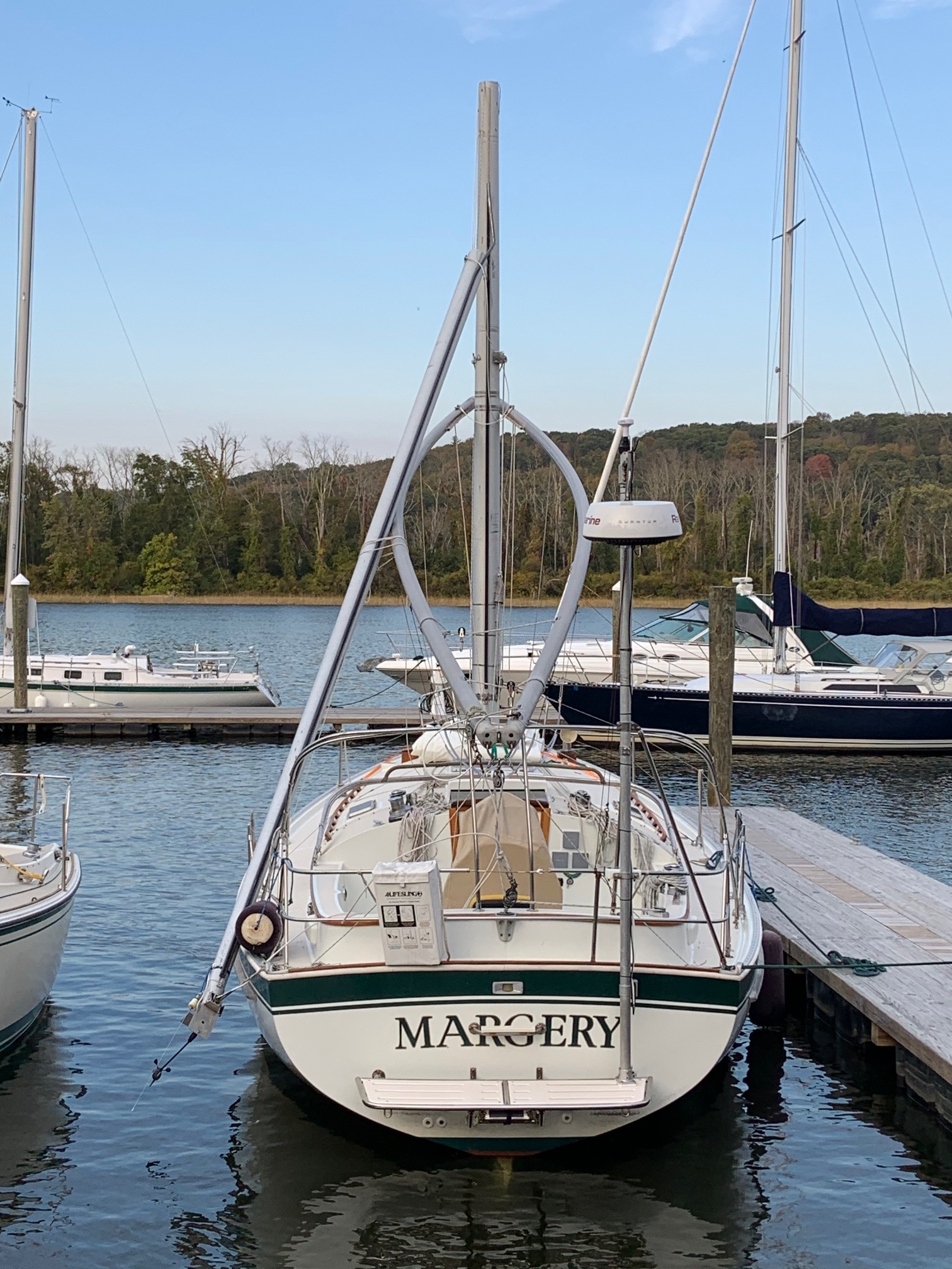

Ward Woodruff
N33 #8 Margery
Niantic Bay, CT

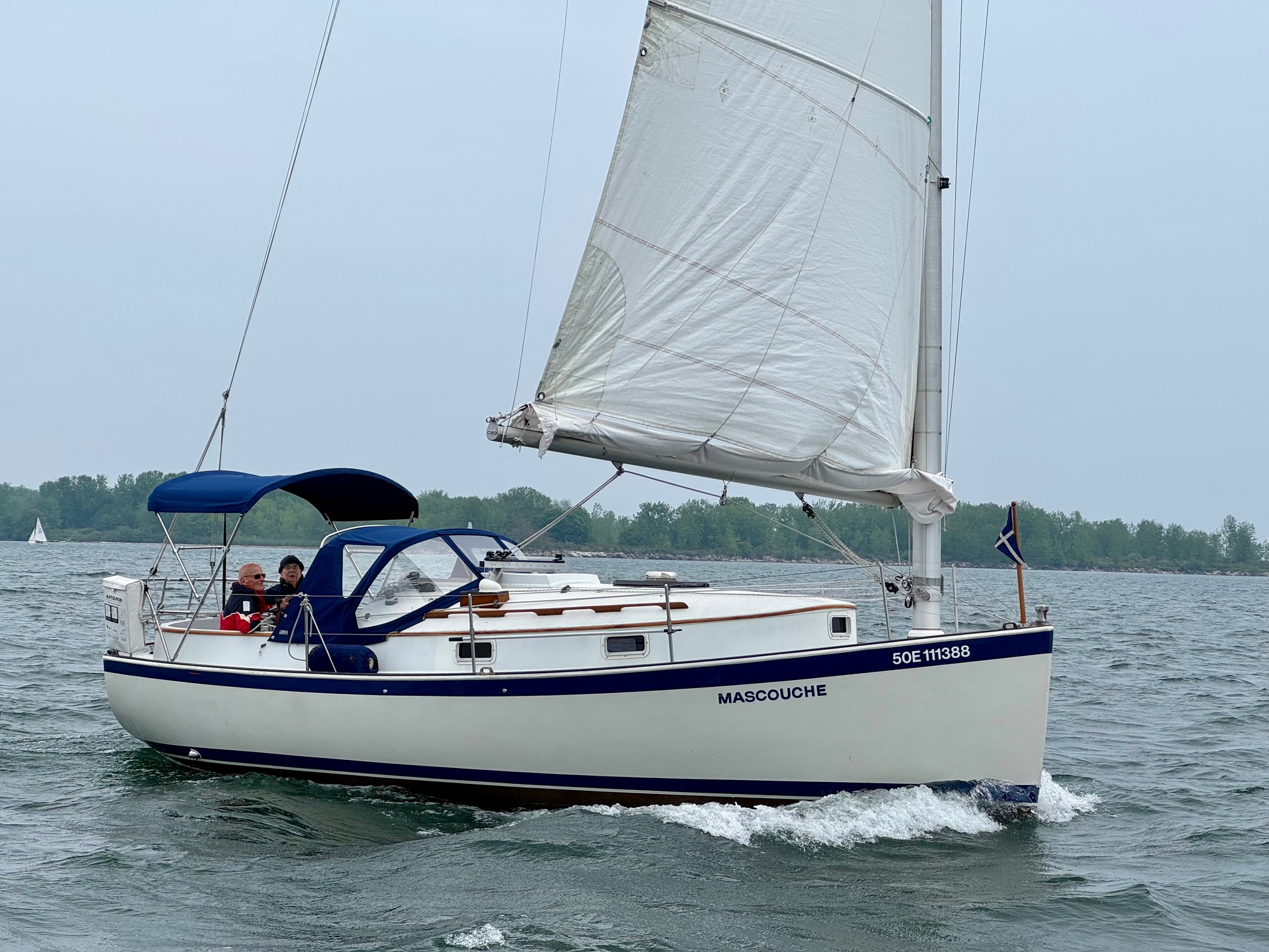

While on a cruise to Whitby, Ont. I was battling the aftermath of a hurricane that produced short steep seas that had the run of Lake Ontario from Rochester. Mascouche was behaving well under the circumstances under a single reef beating to windward. One was very conscious of the “whipping” of the top of the mast. It became too much for the weather vane which flew off. The constant flexing of the mast must eventually fatigue the metal at the deck area. In addition, it makes light air sailing in a swell very annoying. The wishboom tends to rock about spilling what wind there is. I mitigated these issues with the standing gaff rig. The gaff sheet steadies the mast and prevents it from whipping. I see no reason why yachts with standard wishbooms do not add add a backstay. It should add years to the life of the mast. I will leave it to our metallurgists to determine how much longer life one can anticipate. Anyway an inexpensive dyneema backstay should improve the enjoyment of sailing in light airs. Those with boom clearance issues or extended booms might require a bumpkin to provide sufficient clearance for the boom.
An upgrade that should extend mast life would be to replace the heavy aluminium boom with a carbon fiber one.
Mascouche 26C1
Photo taken by Doug Farrand on Quetico 30U #368. The “backstay” is actually the gaff sheet which allows the gaff to be trimmed to the breeze at the top of the mast. On Lake Ontario this can be substantially different to what is happening on the water. JN

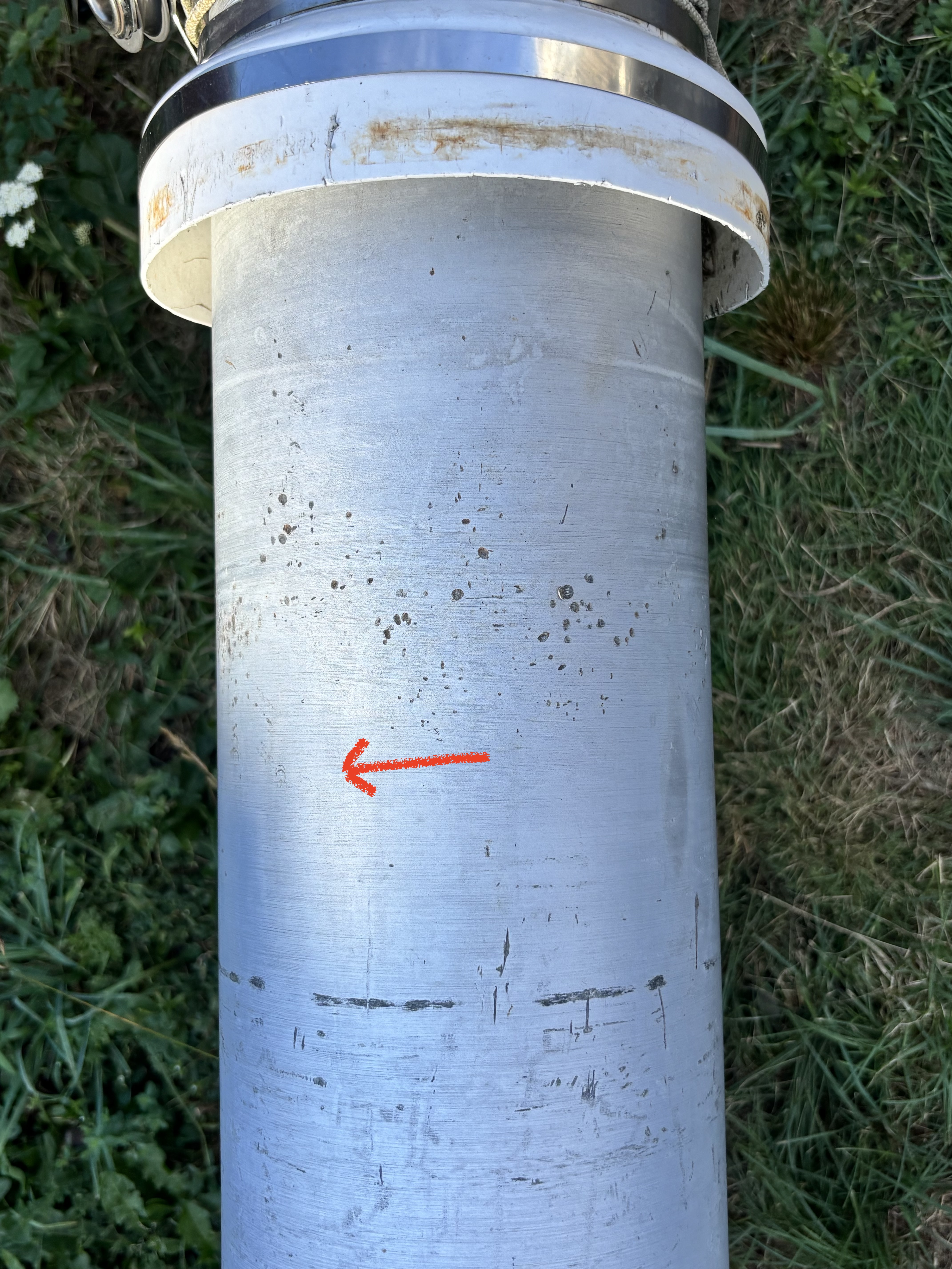

Given the comments and some more history about mast failures at deck level, I took a look at my mast which is on sawhorses in my yard at the moment… and I am concerned about what appears to be ‘pitting’ in that area adjacent the deck partners, along with some abrasions (from getting knocked during 40 years of stepping/unstepping I presume?). Also where you see the red arrow pointing there are some ‘imprints’ of perfect circles about 6mm in diameter which are puzzling. You will have to really enlarge this pic to see these little circle outlines.
I’m interested to hear from you, and anyone else, if this pitting looks like serious corrosion. My first mate thinks it might be a good idea - if its even possible - to insert a tight-fitting aluminum spline inside the mast in this area to reinforce it?
Thanks for any input!

You should contact Mike Quill about it. He advised me on repairs when I found pitting beneath my tack collar. There are specifications for how deep the pits can be and still be safe, but you should ask him because the spec might be different for the area right next to the deck, it being right at the fulcrum. Mine was well within spec and I followed his instructions on repair. You are lucky your mast is on sawhorses! The prep involves sand blasting which is very difficult to do in a nice marina.
