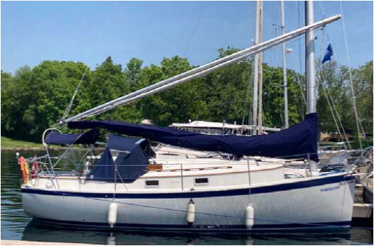

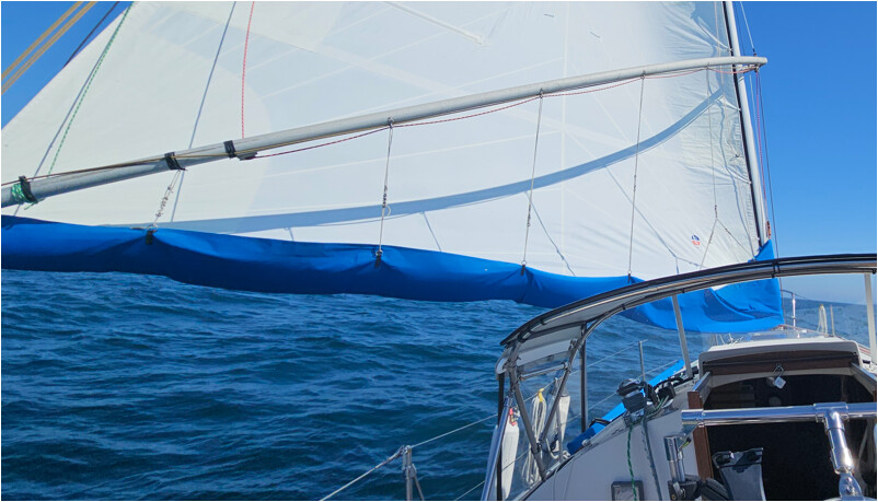

Another, similar design was developed by Chesapeake Bay Nonsuch sailors such as Butch Garren. The canvasmaker who did it has since retired, but I have the documentation and can share it with you. Send me a direct message if interested.
Here’s how that design looks like at the dock and under sail:
As you can see, the two designs look pretty similar at the dock. Both have far less windage, and far lower production costs and complexity, than a Doyle or Mack stackpack.
The first design has less interference with the sail when underway. The second design is lower maintenance, because you don’t deal with the cover other than unzipping it going out and zipping it back up on returning.

I saw Corvus at the 2024 Toronto International. Several other boats had similar covers. They struck me as very nice looking.
I suspect under sail that they appear very similar to the cover designs in my post above. Two differences, both due to the PVC batten poles running horizontally through them:
  1. They will look smarter and possibly catch the dropped sail better because the poles maintain a clean, straight shape to the cover.
  2. They will cost some amount more because of the extra workmanship required to sew the pockets that the PVC batten poles run through, along with the openings where each jackline is tied off to the those batten poles.
