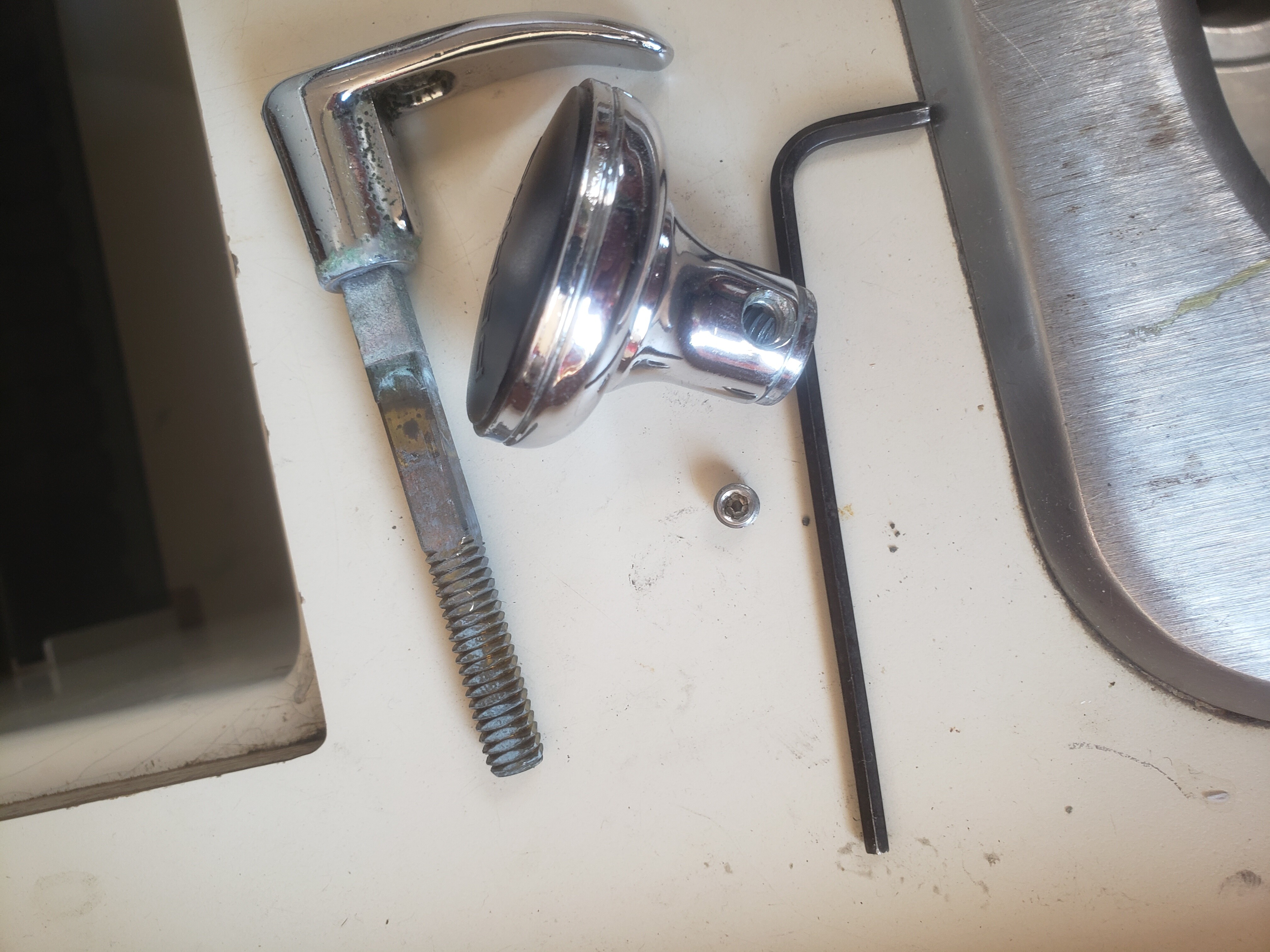

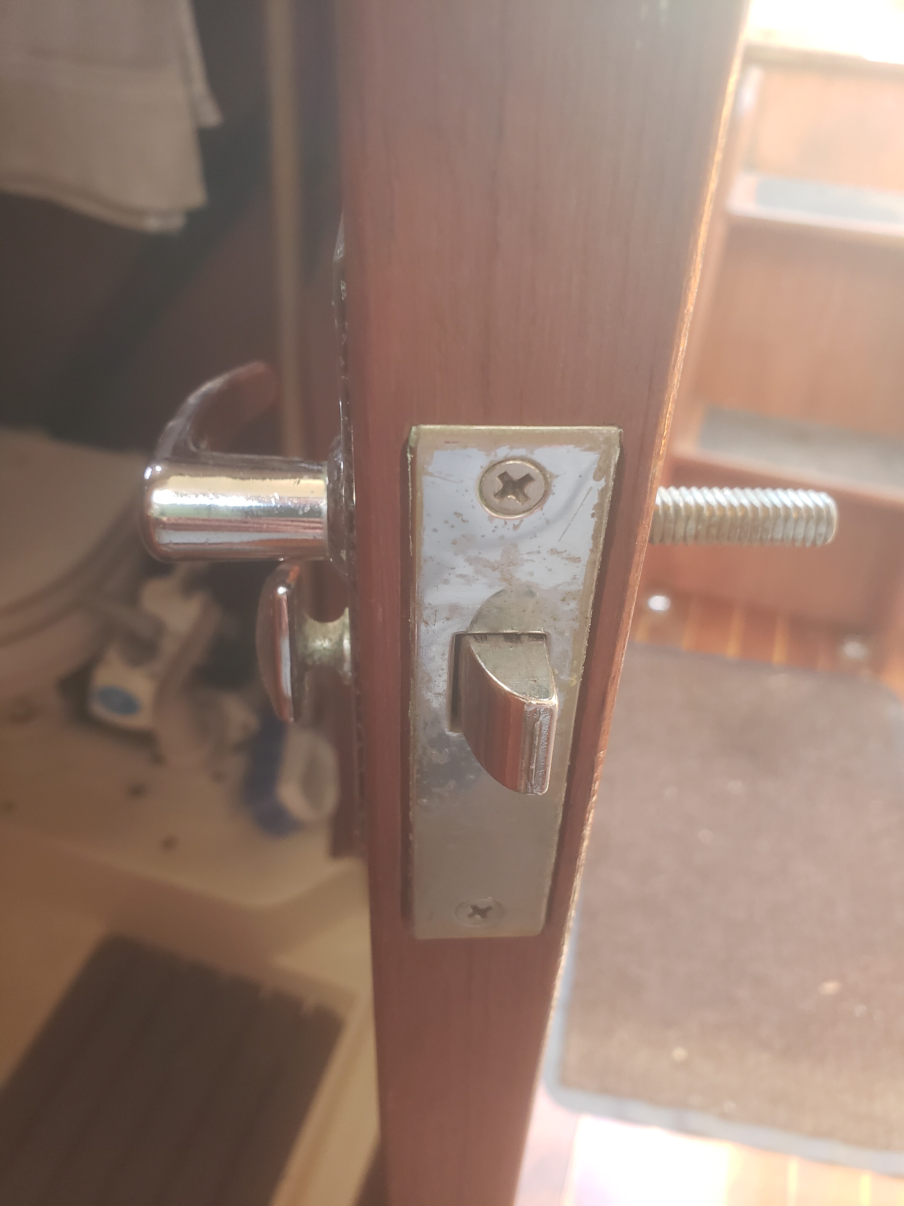

Don: Maybe a photo would help
I just tore my latch apart out of curiosity and it needed adjusting anyhow.
It is a Perco. The cabin side handle screws onto the square, threaded stem. Then, when well adjusted and at one of the right angle positions - up, down, left, or right, you tighten the cone-point set screw, which is a 1/8th socket.
