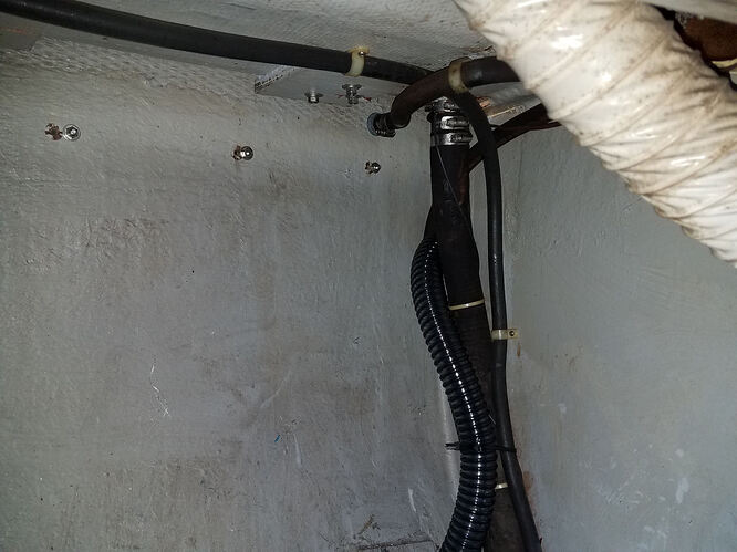

The biggest problem is finding room in a 26. Here is a photo of my installation which is a Force 10 -
![NS30U Calorifier 004.jpg|2288x1712](upload://5eNsA4tiLY2Pq7d1tlc1wKJeNL0.jpeg)
![NS30U Calorifier 005.jpg|2288x1712](upload://AdUkHK30HImXegYjojfbXjfi9j2.jpeg)
![NS30U Calorifier 006.jpg|2288x1712](upload://2PS0SWtIRpQVGexIJODtE42BLRs.jpeg)
![NS30U Calorifier 007.jpg|2288x1712](upload://amCjzqcgZyN6YkMOFJ3zMZHstxM.jpeg)
![NS30U Calorifier 008.jpg|2288x1712](upload://8IUaXzTg8wlxbnV1JoMWKuT70yr.jpeg)
Mike,
After seeing Joe V's pics, I found this heater and with the measurements
checked out the space in my 26. In my boat there is a space in the port
laz above my starter battery. It appears that the heater with both the
exchanger fittings and service fitting on the front will fit. See pics
below. Also on my W21 the heat exchanger portals are on the back which is
a small convenience. Starter battery could be moved to stbd next to my
single house batt for balance.
Cursory look indicated service lines could be run thru bulkhead and run
parallel to fuel tank to get into the bilge for reconnection. I also just
replaced the deck drain hose which you might want to do prior to hiding it
with the heater.
