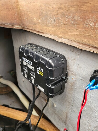

Let’s close out this topic with a couple of photos -
An outdoor weatherproof box with a GFI outlet just squeezed onto the forward partition of the starboard lazarette.
It will make dealing with the battery a little more difficult.
The battery maintainer is on the cockpit wall of the same lazarette. I’ll have have to lean in a bit in order to read it.
The remaining issue is that the maintainer will be the sixth wire running to the battery screw post. OK - the bilge pump, my USB charger and now the maintainer. What would those other 3 wires be…? Maybe the radio, but that had to be rewired anyway… It looks like I’ll have to squeeze in a pair of distribution blocks someplace reachable by the wires running to battery #1.
