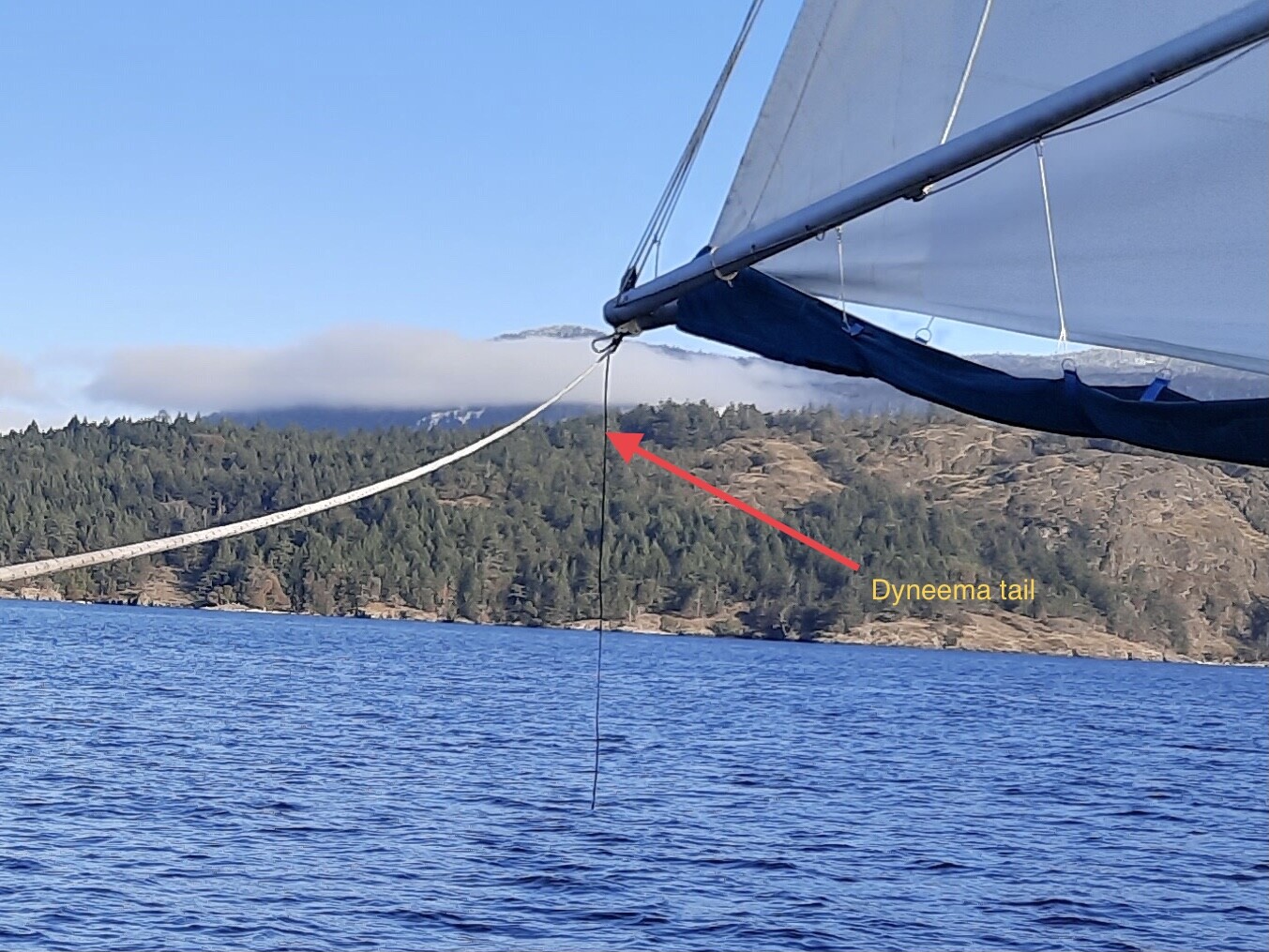

I have a setup that allows me to go to a single line when I’m running in light air and then revert to the original tackle when the need arises. Sorry, the first pic was taken before the Dyneema tail was added.
The dangling tail is for retrieving the carabinier. There is a soft shackle around both lines above the carabiner to prevent it from contacting and jamming on the block.

Dan, retrieving the line isn’t hard if you do it during a tack. Singlehanded you have to be quick but if someone is at the wheel and can stall for a few seconds it is much easier.
Interesting! I’ll try this next weekend.
I used this technique today… totally works! Takes some weight off the sail and is easier to trim. I’ll definitely be setting this up for an even easier way to go from 2-1 to 1-1.

@PaulM and @RonB , could share more details on the soft shackle you use to prevent the carabiner from jamming on the block?

Rupert, my soft shackle is just a quick and dirty one from about 1/4” Dyneema
made with a figure eight knot for a stopper. All that matters is getting the size right.
