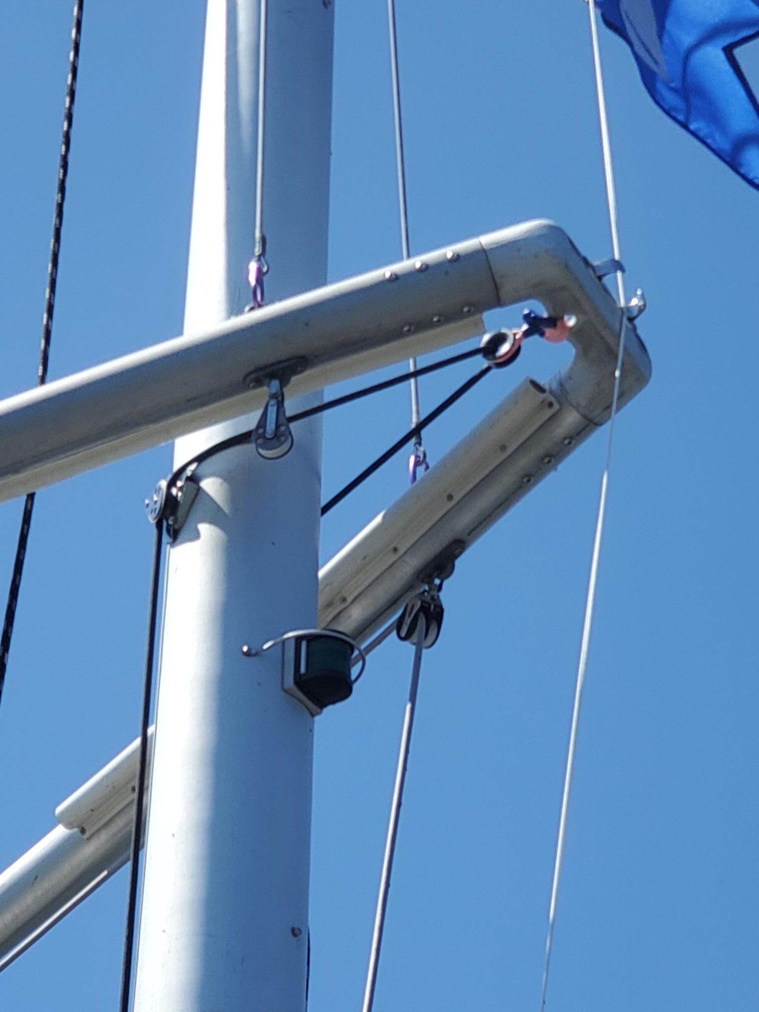

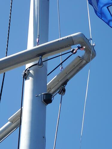

Preface: I know my approach may be Nonsuch sacrilege to the traditionalists, apologies in advance.
From that odd port sided block, I’ve rigged a full time 2nd halyard that I’m sure will remain unused other than to annoy my neighbours with needless “halyard slap”.
On that note (pun intended), I’ve seen folks use bungee cords to good effect, but… I’ve used simple carabiner to hold the “cleat to mast” section away from the mast by buddying up to the “mast to halyard shackle” section that is secured to the pulpit stanchions. Look for the two lines coming down from the masthead and deflected by a carabiner.
However, on the subject of Flag Halyard:
I’ve gone against convention: the halyard is white paracord looped through a shackle at the top front of the masthead. These lines are fed through
a bow chock stuck to the front of the boom and terminate at the mast collar with another shackle. This allows the burgees to fly free and clear in front of the mast.
Other things going on in this photo that we cause squirming in gallery are:
  • Yup. carabiners instead of shackles for the wishbone hangers
  • Low friction loop with a double prusik hitch for the choker.
  • The sky has not fallen…yet.
