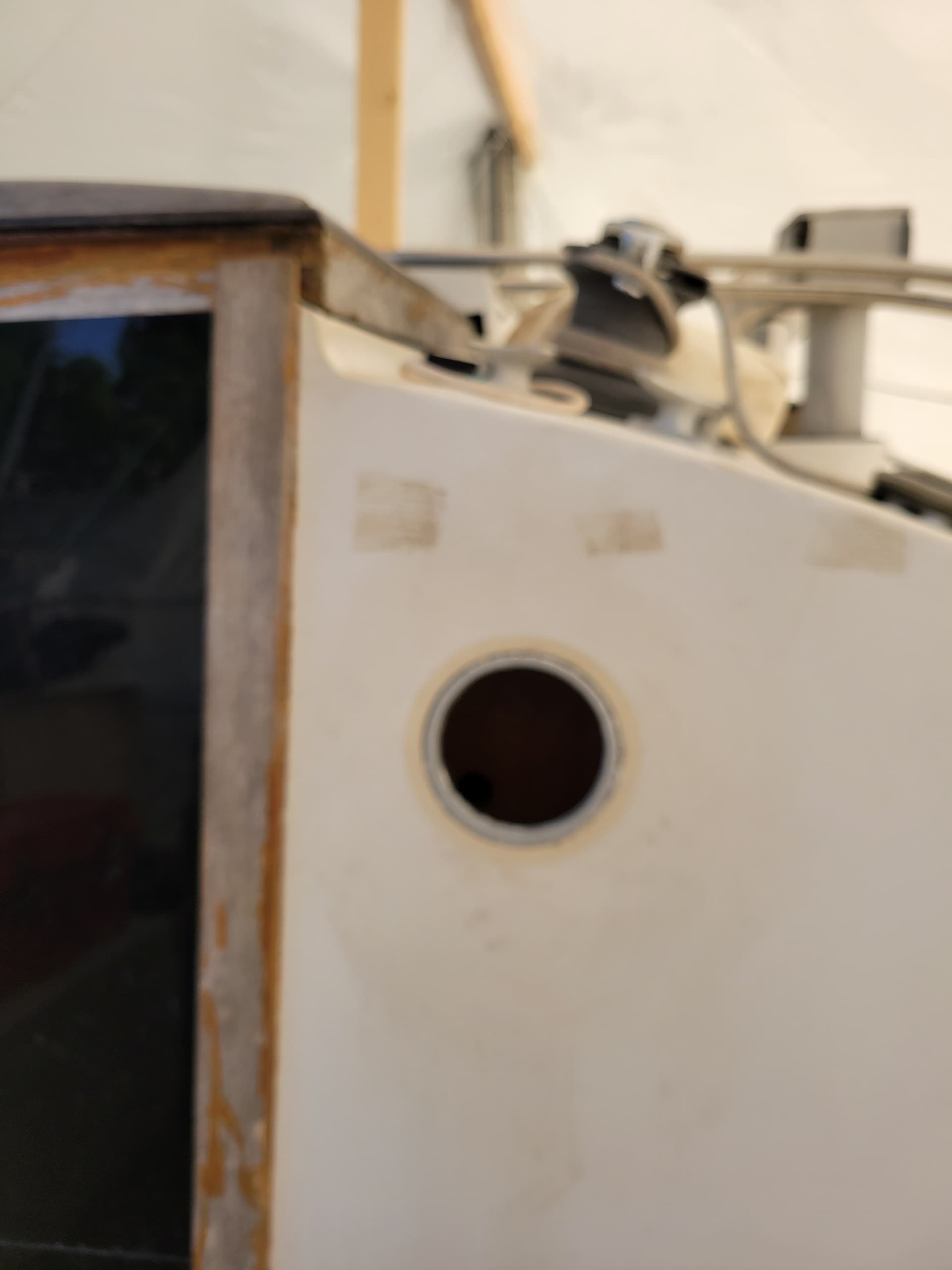

A little update to the on-going saga. Taping a board to the outside worked somewhat, but my idea about glassing in the HDPE ring (to reduce the opening by 1/2") was a bad one. So, after cleaning up the mess (I can now attest to the fact the Goo Gone can remove duct tape residue, and I have enough to last me several lifetimes. I guess I’ll be Gone before the last Goo), I tried a more simple approach with 4200. It’s not structural (the St-60+ attaches outside the ring) and I think after an application on the outside for waterproofing, it will be good to go.
I am planning to mount three ST-60’s and was thinking they should be vertical (within the inside enclosure) and not slanted to match the hatch board angle. Anyone been down this road who can comment?
Jon,
You might try using your picture to mock-up the alternative layouts by making copies and adding circles to represent the additional two instruments in different configurations.
I suspect it’s a matter of individual taste which looks best, along with how you use the boat. E.g., do you have passengers/crew that sit near there? If so, what layout prevents them from blocking the view? Or, do you have lines from the cabintop that overhang?
