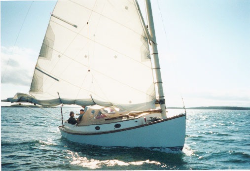

  • first was a Brewer 22 Cape Cod Catboat, traditional gaff rig and wooden spars. Was originally set up with slab reefing using ties through grommets along the reefed foot of the sail. I ran a single line for each of 2 reefs from cockpit, through turning block at base of mast, up to tack reefing cringle, back to turning block on boom, aft along boom to another turning block and up through the clew reef cringle then straight down tied to the boom. I ran a line like this on either side of the boom, one for each reef. This made it plausible to reef single handed from the cockpit. I did not have an autopilot on this boat so that was handy. In practice, there was so much friction on this setup that I tended to set the reef before leaving the dock, as it was much easier to release it than to set it when under way. That boom was about 18 ft long and a very heavy sail (plus the weight of the gaff).

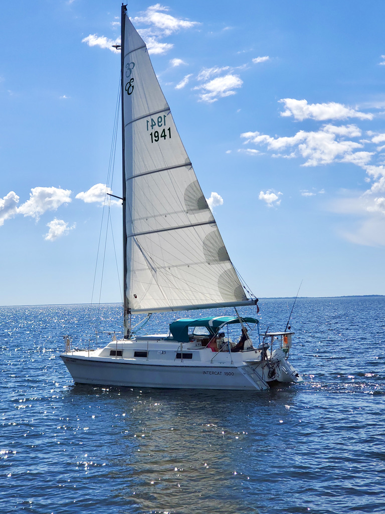

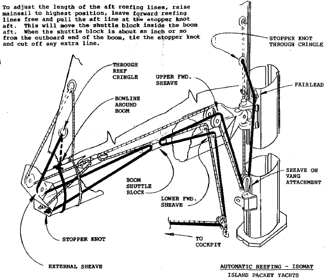

  • second was an Intercat 1500 – an unusual boat – a cat-rigged catamaran of 28 ft LOA x 14’+ beam. Sail area and boom length very similar to the Nonsuch 26. This was a 1990 build which we acquired in Punta Gorda Florida in 2020 and used it as a winter liveaboard there for a few years. This vessel came with an in-boom reefing system which took me a while to figure out until I saw the same thing on a friend’s Island Packet and was able to identify it as an Isomat Reefing System. I have attached a diagram of that here. I was very careful not to lose any of the lines (two at aft end, 4 at foreward end) inside the boom as I had no idea how I would fix that problem. We sold the boat last year, after surviving Hurricane Ian on the hard; and thankfully before the recent Hurricane Milton, while it was moored by last owner in Charlotte Harbor and is now ‘lost’. In fact the whole marina where we were based (Fisherman’s Village) was pretty much destroyed by Milton. My friend’s Island Packet docked there wound up a few blocks inland impaled on a fence as a result of the very high tidal surge. It was sadly written off due to significant damage.
I see from Gary’s (Aloki) post and diagram of June 2.24 in this thread, above, that there was a similar system to the Isomat rigged for one, or some Nonsuches. It looks like it would be a challenge to fix it if anything goes wrong inside the boom. I would not recommend this type of system due to its complexity. Also, any single line system would not permit the prescribed routine for setting a Nonsuch reef, which requires separate setting of the tack reef and halyard before setting the clew reef and choker. One interesting difference between the Isomat system and the one Gary showed is that the downhaul reefing lines to the tack cringles are dead-ended in the tack cringles with stopper knots rather than returning to the base of mast.

Just for fun I’ve attached a picture of the Intercat 1500 under full sail, and one of the Brewer Cape Cod Cat with a reef in.
I used the diagram to replace all lines on my 260 this summer. Just make sure to tie a figure 8 or more before pulling a chase line, or you will have to try to rethread lines internally. Such a mistake cost me two or three extra hours.
Greg, Thanks for the detailed response. I can see how friction could be a challenge. Nice boats!
