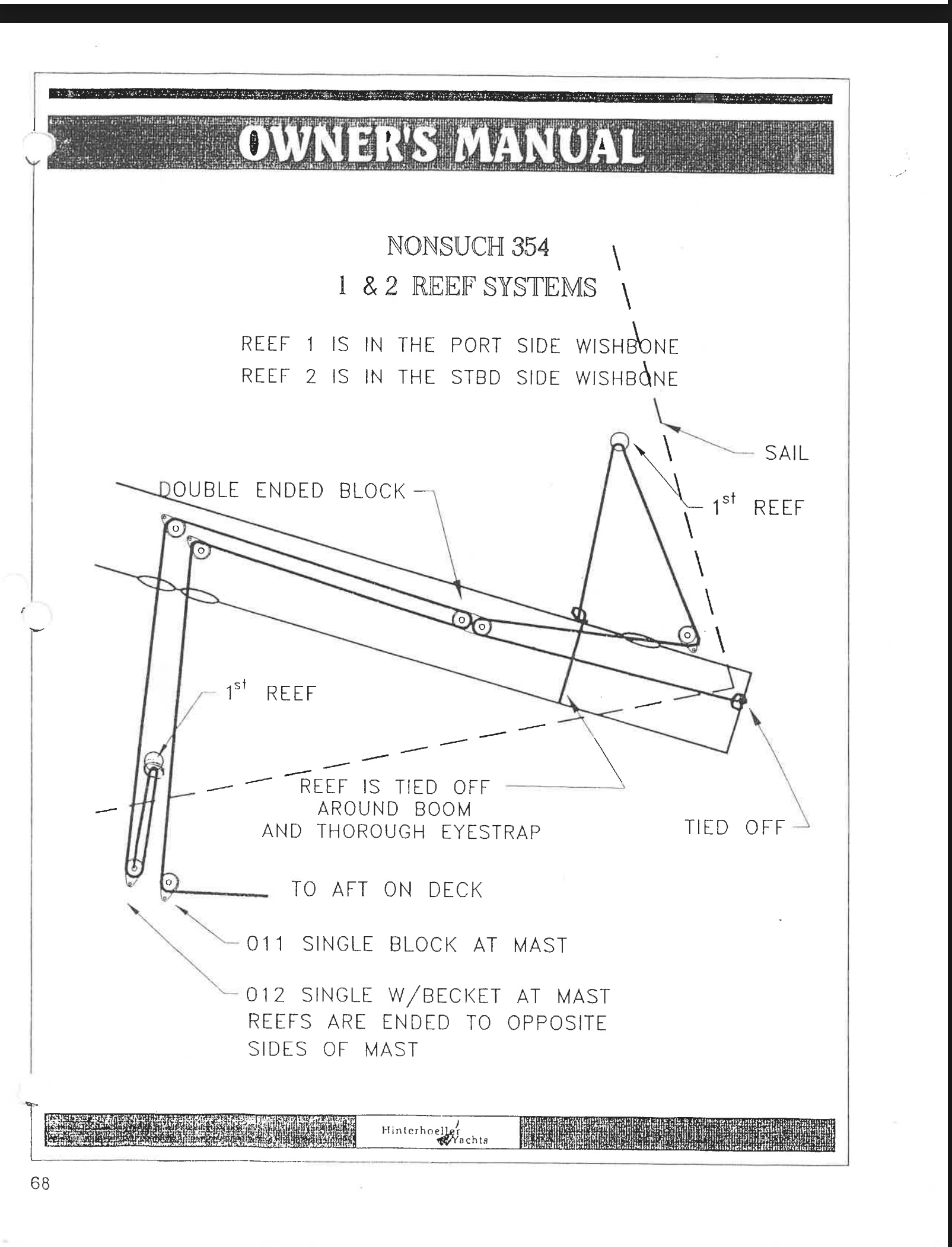

Can anyone kindly provide a line drawing or info as how to rig the single reef line for a Nonsuch 260? This is a slab reefing method where the clew line runs inside the carbon fiber wishboom and connects to the tack as well. In other words , one line is used to reef both the tack and clew line simultaneously from the cockpit. It’s duplicated for the second reef.
At the bow end of the boom there are two lines that exit the boom and when you pull on one, the other tensions up and visa versa. I don’t comprehend how the line running back to the clew connects to this setup. Scratching my head here. Thnx..

Gary,
Because the single-line reefing system was introduced with the newer boats, most of us – including me – have little to no experience regarding it.
I did take a look at the manual on-line, though, and found some information which might help.
If you download the Nonsuch 260 manual from the www.Nonsuch.org website, you’ll find the diagram I think you’re looking for on the very last page. That page is numbered as page 68 in the text, but the PDF counts only 65 pages, so it appears that the on-line copy is missing a few somewhere.
Many thanks Bob, I found it. Only issue I now have is how to thread two lines around that double block.wish me luck. Gary

Gary,
Go to the 260 manual in the Membership section of the INA site. The diagram is the last page of the manual. Page 68 of the manual 66 of the PDF.
I definitely wish you luck on threading lines through that double block, Gary.
As near as I can figure out from the drawing, the double block has to somehow be able to slide forward (and backward) in the boom because the forward lower part of the reefing line being drawn back to the cockpit looks like the key to tightening both forward and aft ends of the reef.
If that block can be slide back close to the one of the line entry holes through the boom, that might make it easier.

All I can detect in my diagram that I can understand is that there are two lines, one each per reefing grommet. Each is tied to the boom, goes to the grommet, returns, enters a local block, runs forward through leads to the forward block, down, through another block and turns to the cockpit.
From these conversations, there seem to be a second set of lines that I do not understand. Perhaps the terminology is confusing me.
I was hoping for a photo, but an explanation of the “second lines” would be great.

Richard,
Unless I missed it, your reef description seems to only include the line attached to the sail’s clew. There’s a second line at the mast that attaches to a cringle on the sail luff. Actually there are two pairs of reef lines for each of the first and second reefs.

As I understand single line slab reefing, it would be hard to accomplish with a wishbone rig where the forward end of the “boom” is high above the tack of the sail reefed or not.
In the slab reefing I have used on previous boats, the line would start aft on the boom, go up through the reef cringle, return to the other side of the boom aft, run along the boom to the forward end, turn up and go through the tack reef cringle, return to the forward boom, and then run aft to the cockpit. This obviously requires the boom to be at the bottom of the sail.
(Even on a much smaller sail this line becomes VERY LONG)
