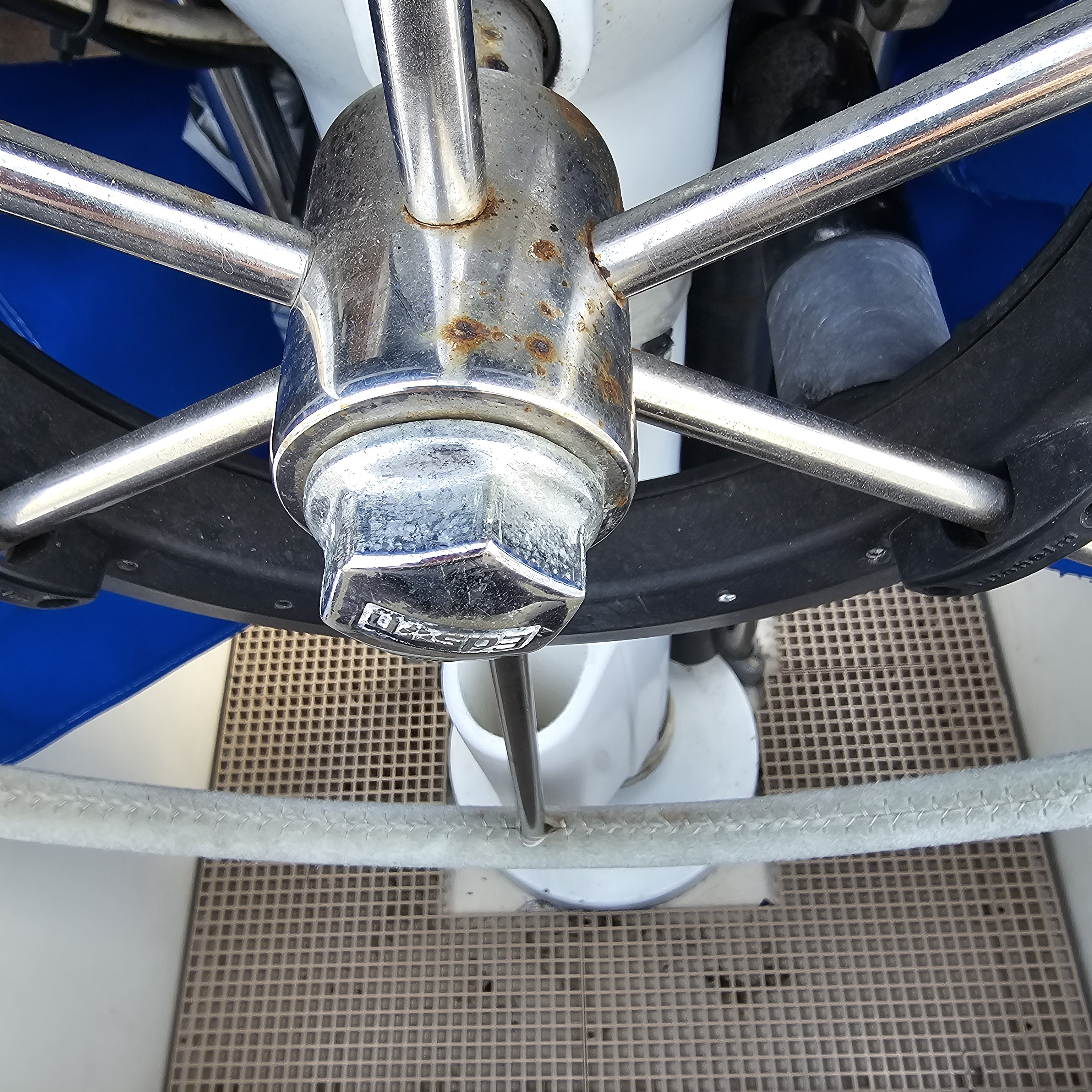

A potential problem with Nonsuch owners using the Davis rudder position indicator – the picture Mike Read posted shows it attached to a powerboat rudder. I took a picture of my wheel to confirm my intuition that the wheel lock nut isn’t shaped to be very friendly to a robust stick-on attachment.
The nut has a relatively small area, and its face is curved.
Sadly, this picture also illustrates that I have a lot of deferred cleaning and polishing that I have to get back on top of.
