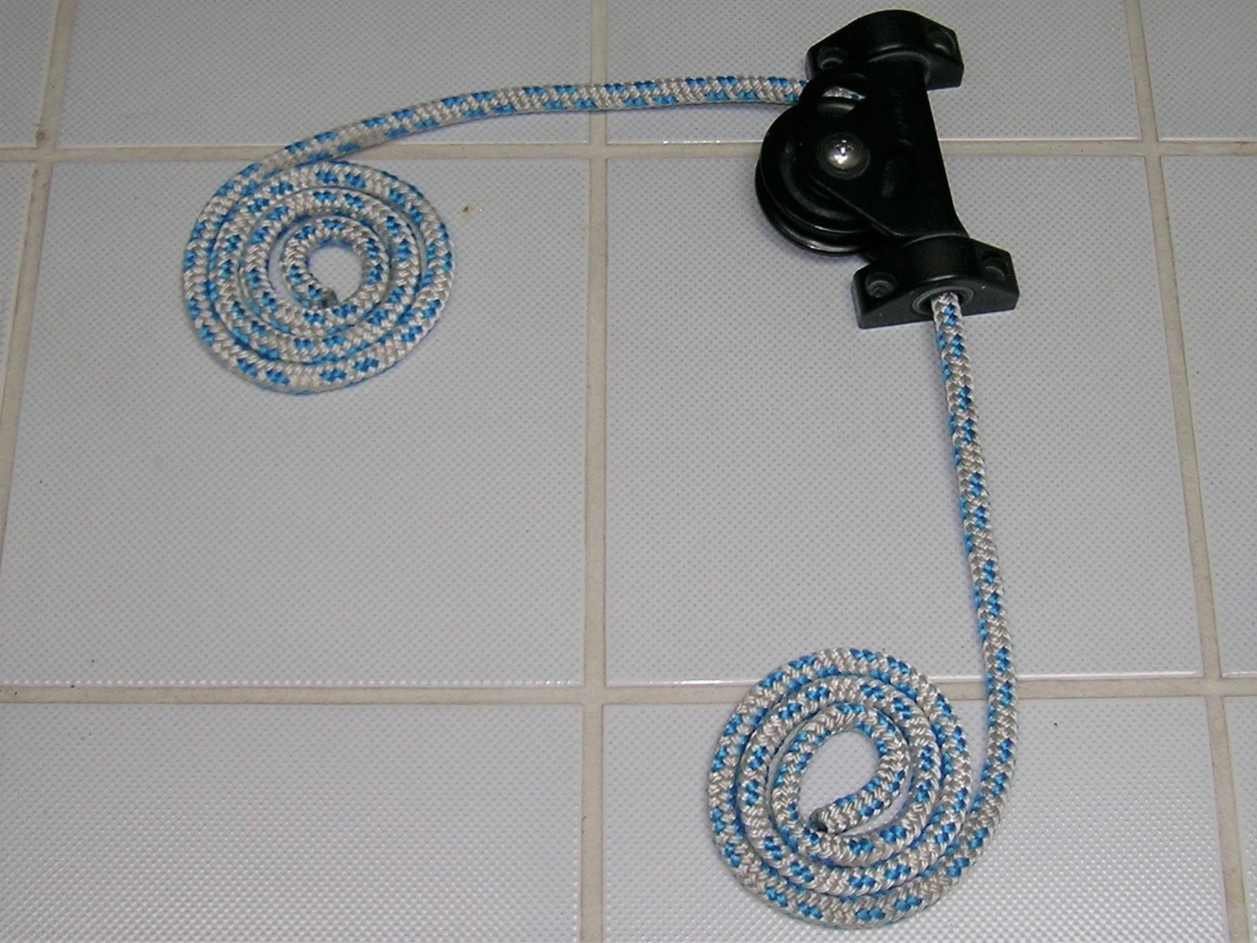

A Nonsuch 26 should be able to overtake larger boats when on the run with her regular sail as long as the mainsheet is long enough to permit the boom to go to 90 degrees and even beyond 90. The choker needs to be eased to create an airfoil. It is very satisfying overtaking a fully manned yacht with all hands trimming sails when one is passing them single handed with little to do.
The one weakness is the fixed choker block on the mast when running on the starboard gybe. If I continued using a wishbone, I would have switched it to a flip flop Harken. (See photo) which aligns the choker with the sheave. I used one of these mounted on the cockpit combing to replace the original Schaefer stand up block which prodded me in the back too often and finally hooked my sweater pinning me to the seat. I had to remove the sweater to extract myself. The flip flop solved the problem as well as removing the the risk of the block failing causing the wishboom to flail until it is lassoed. I had the bitter end of the mainsheet anchored elsewhere so at least I could control the boom if the block failed even when single handed. Fortunately it never did.
