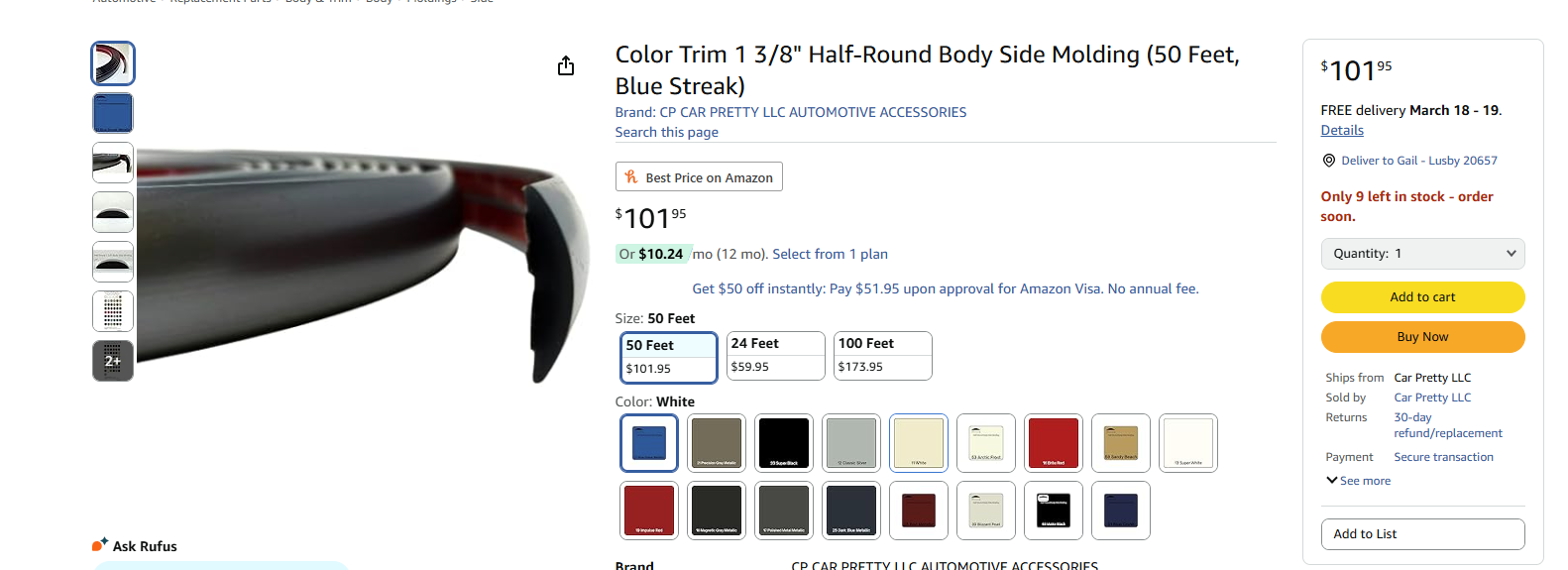

I’d rather wrestle with a porcupine than to deal with the eyebrow ever again. I am going to go a different route that I have been watching for quite some time. It’s flexible car trim. Dave who bought my Nonsuch 22 installed this stuff, and it took less than an hour to do so, after he prepared the boat surface. It looks good, it wintered well, and it is fairly inexpensive. https://www.amazon.com/dp/B0CGJL9L4J?ref=ppx_pop_mob_ap_share
Anyone have any thoughts about it?

Butch, my back has gone on strike and I’m finding working on my boat much harder, so I can only sympathize with your preference for wrestling porcupines over doing the eyebrow work. I myself would never sign up to do boat eyebrows on a regular basis. It’s not a job you want to do a lot of times. I’d looked at similar solutions to your friend Dave’s. It seems like a great alternative. It my case, I was trying to retain the traditional look of teak but with lower maintenance.

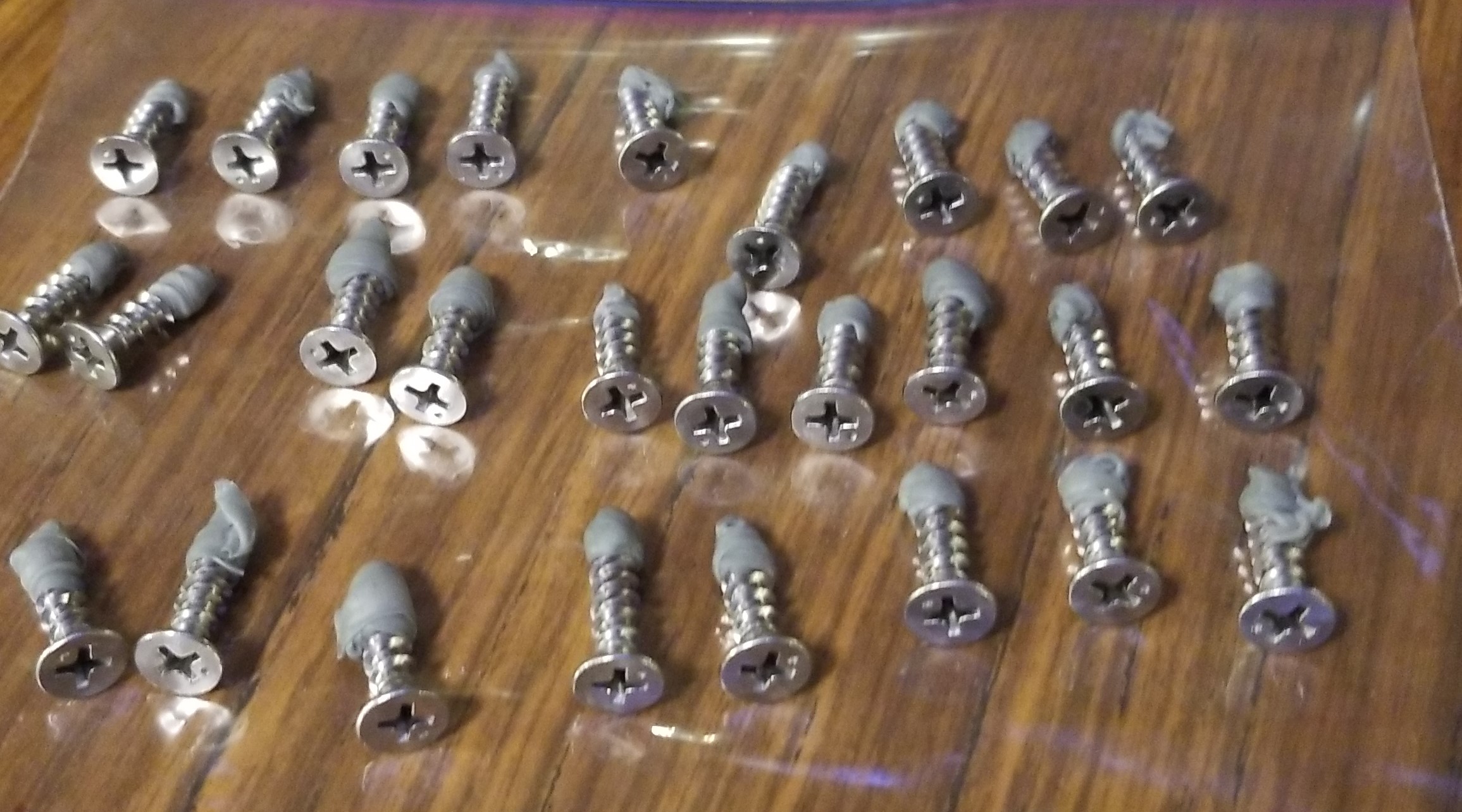

Greg, I don’t think you want to put an adhesive in the scarf joints. Synthetic teak expands and contracts ever so slightly with heat and cold. If you butt the pieces against each other w/o adhesive, that’s enough space for the pieces not to get in each other’s way when that happens. For the same reason, you want to drill the holes for the screws just one size larger than the threads so that any expansion doesn’t push them around. The screws should thread only through the cabinside. I used Fastcap Speedtape (https://www.fastcap.com/product/speedtape) as an adhesive backing. It’s strong enough to hold pieces temporarily while screwing them in, but not strong enough to be the sole permanent attachment. If my memory’s correct, I used 3/4" screws – I think they were #8 but maybe they were #10. Here’s a picture, showing them tipped with Bed-It butyl tape (https://bed-it.com/) to seal them as they screwed in.

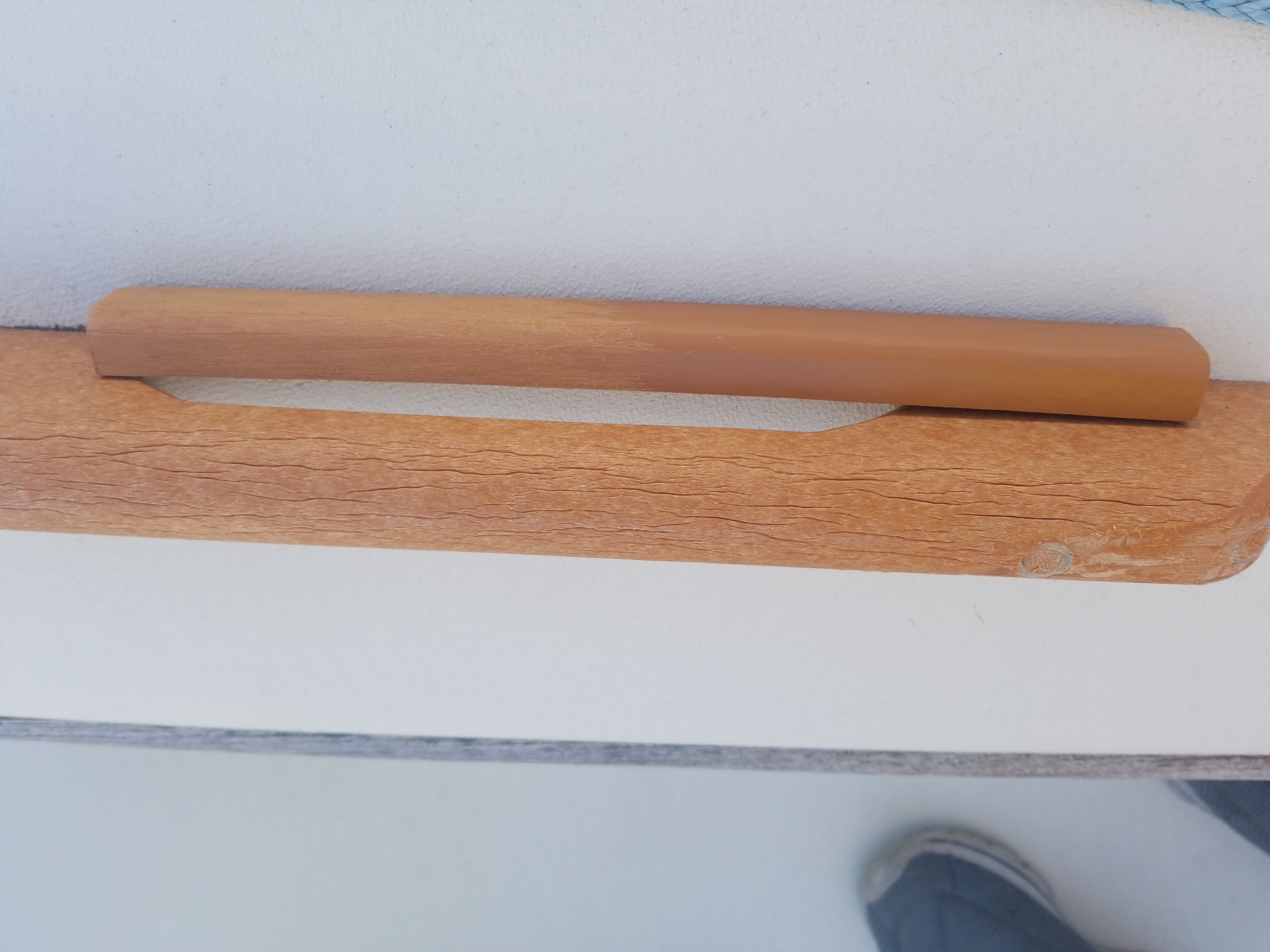

Here’s picture of how the PlasTeak I used for the eyebrow compares to PlasTeak grab rails. If you look closely at the picture, you’ll see the left side of the sample’s been sanded with 40-grit sandpaper to produce a bare teak texture, while the right has been left as it comes from the factory with a finish that looks more like heavy coats of Cetol.

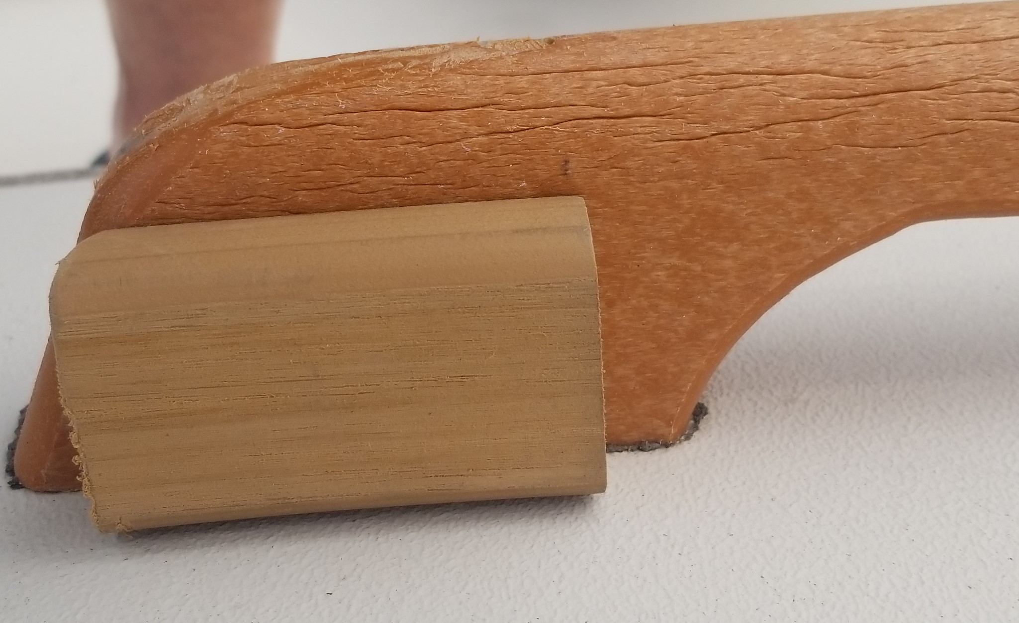

For comparison, here is the competing product from Flexiteek, which comes with a raw teak look, but a significantly lighter shade:
