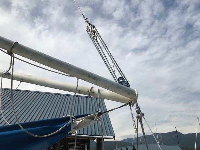

I’d run the line conventionally along the boom but, just maybe, attach a few small blocks to the boom and run the line through them - less friction. I’ve attached a shot of my T/L line running through one of two little blocks.

Yup, that is exactly correct. However, if you really wish to reduce some friction, simply pick 3 eye straps and tie a small block to them and run that line only through these blocks (as opposed to all of those eye straps. It’ll help a lot.
Thanks Ernie,
Are you using 3 blocks on a wishbone for a 22? Do you think you’d up that for a 30? Also, regarding your photo, it’s hard to judge from just one perspective. Do you notice any chafing by the blocks on the sail from time to time?
Gail

I am only using two little blocks. Meaning - aft end of boom, thru to two little blocks and then to the front double block and straight down. I also worried about chafing the sail when I went to this setup but the blocks don’t even touch the sail.
