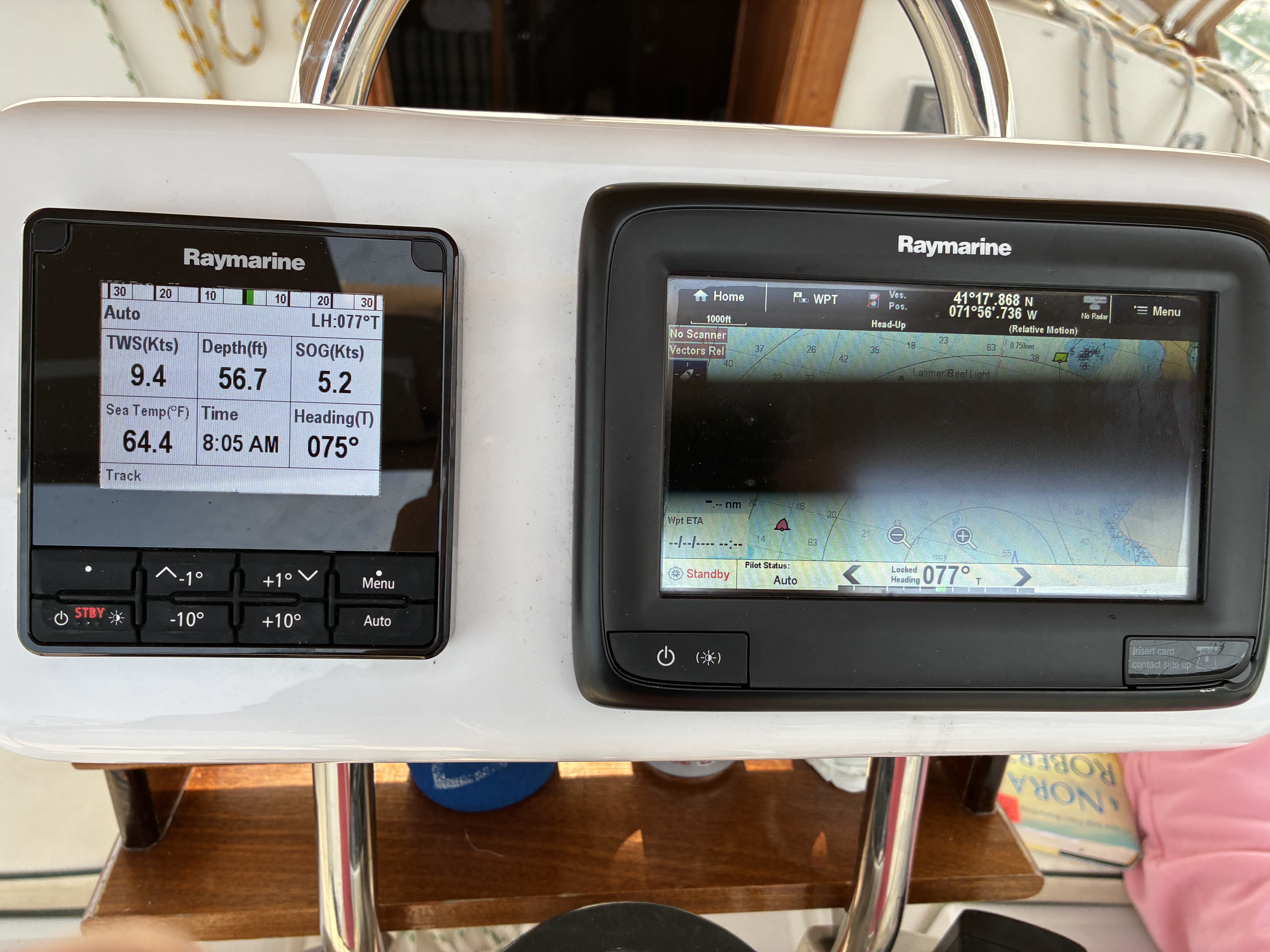

Here are two photos of my cockpit located nav instruments. The three on the bulkhead are 0183. The two at the helm are 2000. There is a Raymarine 0183 to 2000 converted in the cubicle behind the bulkhead instruments.
A paddle wheel transducer sends speed through the water to the bulkhead speed display. An Airmar depth/temp sends that info to the depth display. The pilot head at the helm repeates those signals if selected.
I display SOG, depth, TWS, sea temp, time of day and water temp at the helm. I display wind speed/direction, speed through the water and depth on the bulkhead.

From the photos, I see your AWS is 13.6 at 35º AWA, boat speed is 6.4 and SOG is 5.2 so you have a stiff opposing current. Is this a typical upwind setup for best VMG with Margery ? I think this is a little faster than I see on Soave… but maybe I’m pointing higher than I should ?
Do you experience much weather helm with this setup ? On Soave after the mast rake adjustment on a starboard tack in similar conditions my wheel would be at about 2 o’clock. Before the rake adjustment I’d be at 3 - 3:30. The thing that was killing me before the adjustment is that a gust of 16 with this setup would require the wheel beyond 4 o’clock.
Do you happen to know what the connector on your speed transducer looks like ? I’m guessing the wire from the paddle wheel is analog driven by a magnet running to the speed display that counts the pulses and calculates speed.
Output from the speed dipay ( NMEA183 ) probably runs from the speed display to the your converter which outputs NMEA2000 for your instruments at the helm ?

We are on the first day of a two week cruise. The instrument photo is indicative of motor sailing against current so, not a good indicator of sailing performance. Our destination is directly up wind and up current. We went back to straight motor after two hours with the sail up.
5 wires from speed transducer to instrument.
