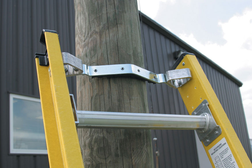

I use a V Pole Grip Rung at the top of my extension ladder. It just bolts onto the top of the ladder in pre-drilled holes.
This is Werner’s version, but other ladder makers have them too. There’s no price listed on their website https://www.wernerco.com/us/products/ladders/ladder-accessories/71Series/71-1, but I think I paid around $50.
It works great, and keeps the ladder from shifting side to side. I tie off too, of course, but it is pretty solid on its own.

I support the use of the V-pole grip rung. I made my own (long story) and the ladder rung sits into the mast track.
