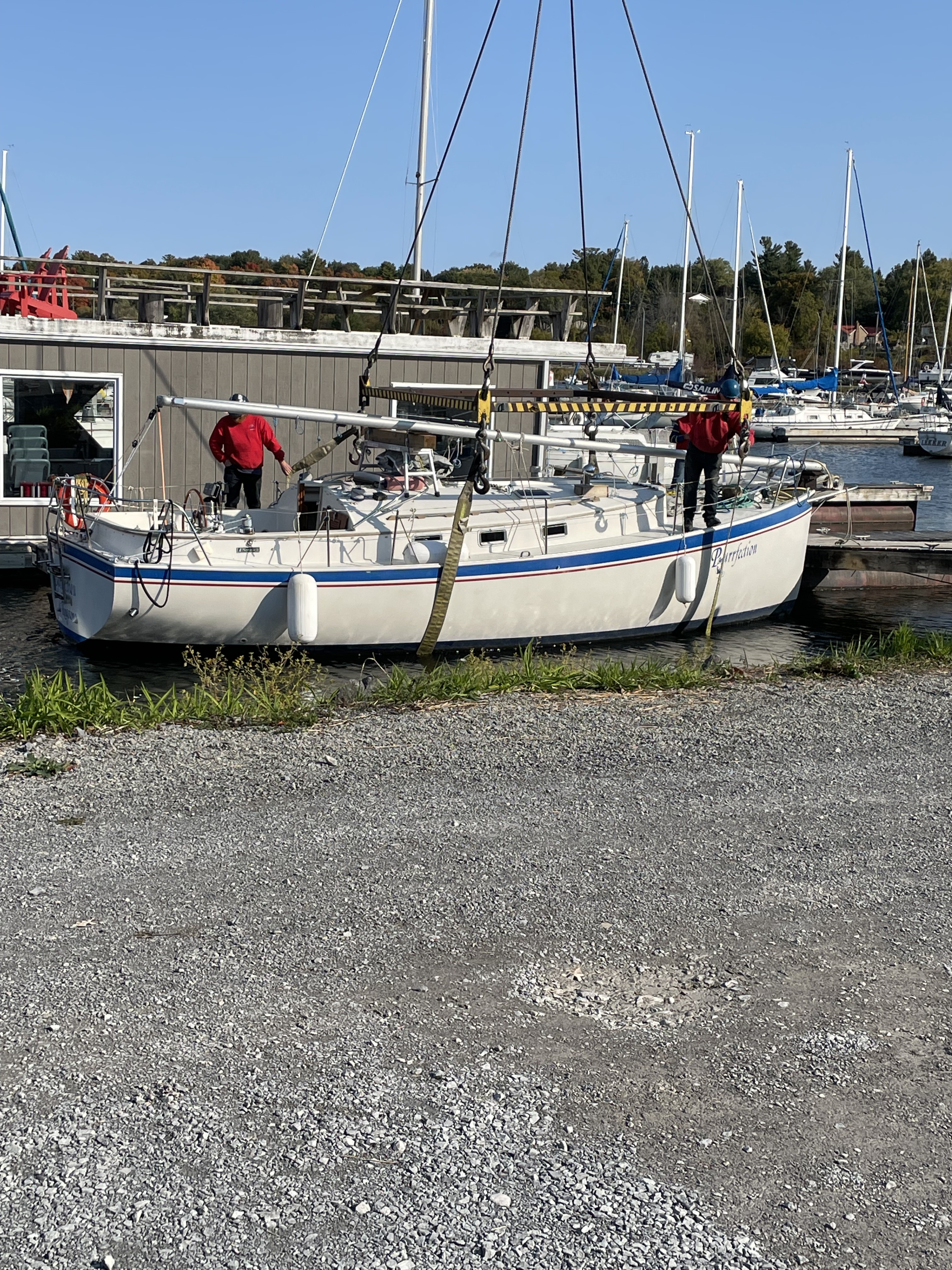

Brian,
I’m sure you are going to get lots of suggestions for the wishbone cradle, permanent or temporary.
Yes, we do this each year in the marina and move around with the boat rigged like this very comfortably. Those who have transited the canals will probably have done something similar
I’ve attached - if it works - a couple of photos.
I use a Mastercraft workbench topped with a 9x9x9" beam to support the rear of the boom placed on top of the cabin at the companion way. Other solutions I’ve seen include a crucifix structure in the cockpit, the vertical element secured to the pedestal or cockpit wall/winches. Obviously everything gets braced/tied down as appropriate to ensure nothing moves.
At the front it is supported at the Samson Post - I made a simple supported beam from scrap wood that spreads the load a bit between the post and the deck (and copied from my neighbour, Ken Dakin, NS33 Sashay). Many boats simply secure the boom to the pulpit but like Rob I was uncomfortable with that arrangement.

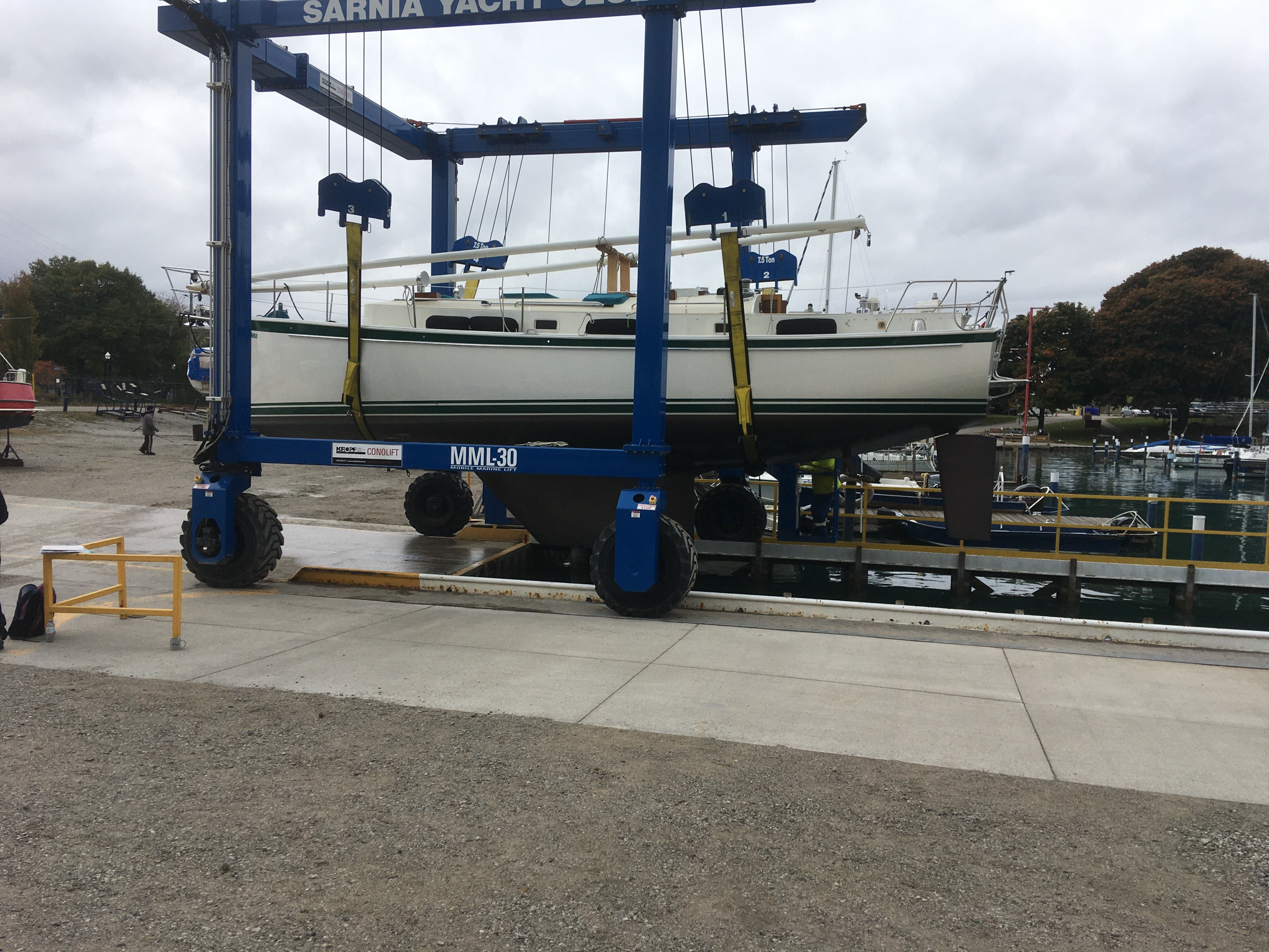

Here is another example. We do support the front of the boom from the pulpit. It hasn’t been a problem. We do take the Bimini and dodger down first
