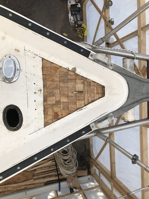

Aside from the issue of the power inlet, I have some experience removing wet core and repairing - this was on a Niagara 35, built by Hinterhoeller in the same shop, using the same construction methods/materials as our Nonsuches. I can show you lots of documentary photos and share copious amounts of advice, but to keep it simple here:
  1. first determine the extent of the wet core. I drilled 1/4" holes at intervals (about 2 - 4" apart, no more than 1/2" deep) radiating from the determined soft spot(s). You can easily see the difference between wet balsa core and good dry core by what comes up with your drill bit (wet stuff is blackish and mushy). Before you start drilling, use a nylon headed mallet to ‘sound’ the deck and that will give you a good first notion of how extensive the damage is. If it is wet and likely delaminated, you will get a dull thud or reverberation instead of a crisp ‘knock’ sound. Once you get to dry core, stop drilling test holes. These ‘dry’ holes are easy to repair by filling with thickened epoxy and not too noticeable (you can touch up the blemishes with white epoxy paint or gel coat.) Mark out the affected area and record that with photos.
  2. there are some finer points about cutting out the relevant pieces of the top fibreglass layer, in manageable sizes, cleaning up, re-coring and re-using the panel you cut out by laminating it back on and fairing it. I will be happy to share progress photos. But the point I wanted to make here is, I would not recommend using balsa if you have any extensive work to do. It can be difficult to work with. I recored much of my deck and coach roof in 2 - 3 sq ft sections, over several months, and the balsa changed size with humidity changes in my shed - so it would not lay down flat on its webbing. I spent a lot of time drying it out bit by bit. I suggest using a closed cell core like Divinycel foam instead. Easier to work with. I had a subsequent boat that needed about 30 sq ft recored and it was much easier with the Divinycel than the balsa. You will need core that is 1/2" thick.
  3. I have never heard of a boat that sank due to a soft deck - no need to do this work in our limited northern sailing season.
Pic attached is of replaced core around a chainplate - a very rewarding first patch in my journey.
