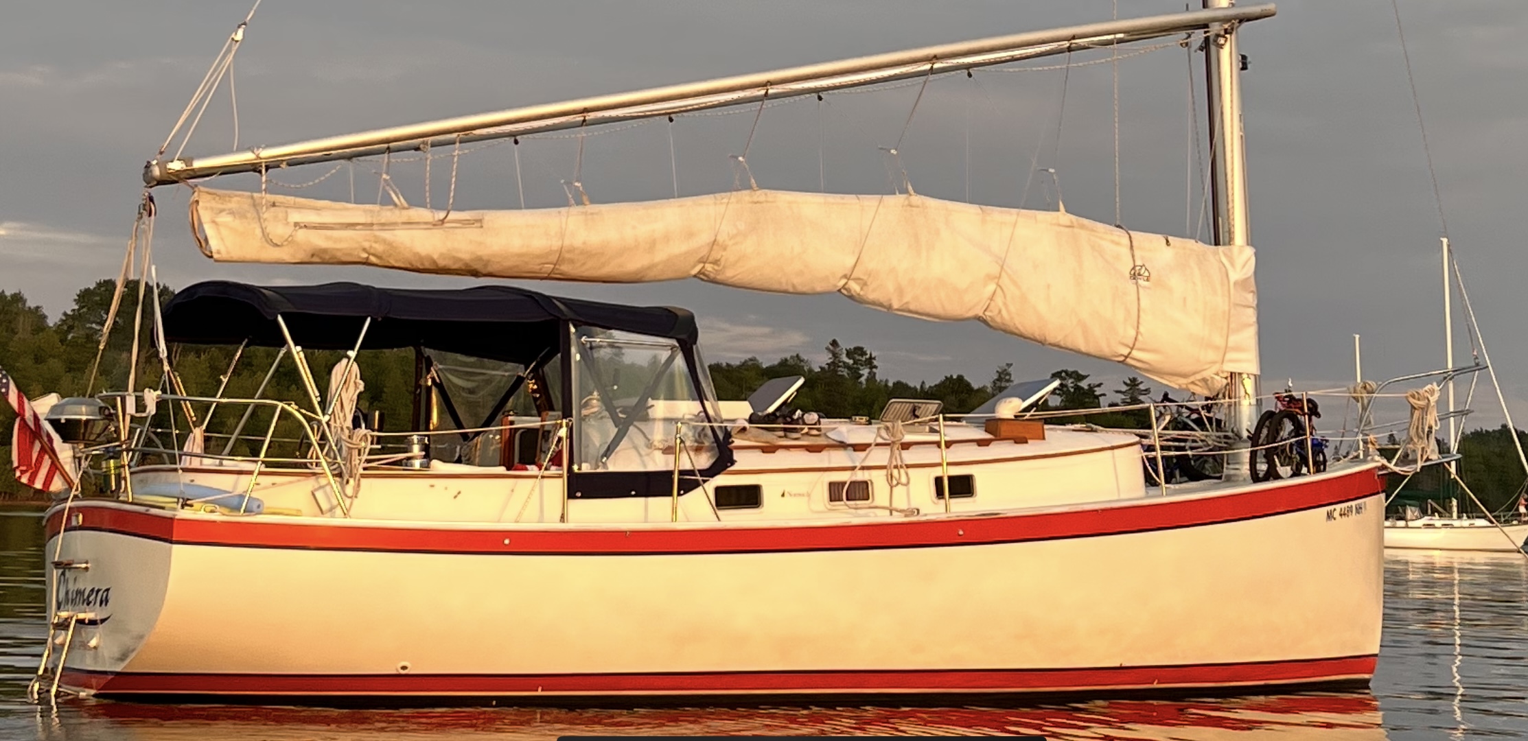

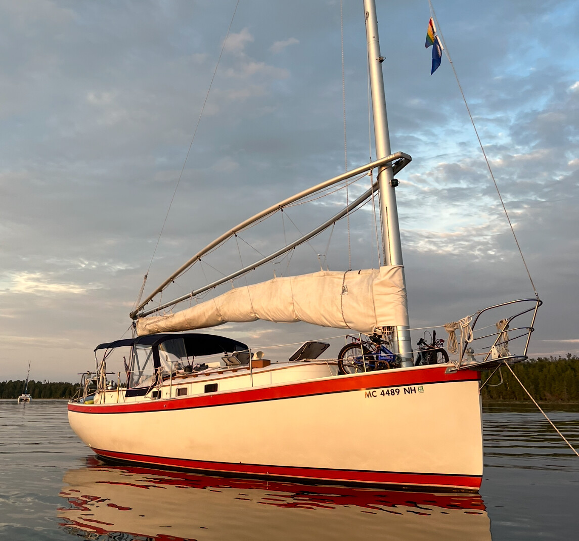

  1. The previous owners selected white Sunbrella for the pack thinking that it would look better while under sail rather than having the bottom 10% of the sail appear to be a different color. As you can imagine, a white cover out in the elements season after season just starts to look pretty shabby, and despite having had it professionally cleaned twice it just looks dirty all the time. And that’s just not how we keep our boat. The photos show what I’m talking about.
  1. The Doyle loft that made this particular Stack Pack had little, if any experience making one for a Nonsuch and, frankly, did a rather poor job. Hanger lines were attached along the top of each side with no webbing or anything “cradling” the load of the sail and pack. Subsequently, the angle of the hanger line was much sharper, and pulled against the fabric holding the zipper across the top as the load was not properly supported from below. Eventually, tears started forming on either side of the zipper and, despite my attempts to create cradling hanger lines and minimize this stress, the top of the pack was basically destroyed. This photo shows my prototype at “cradling” hanger lines. Once I had the dimensions figured out, I remade them with webbing along the bottom of the pack instead of line.
