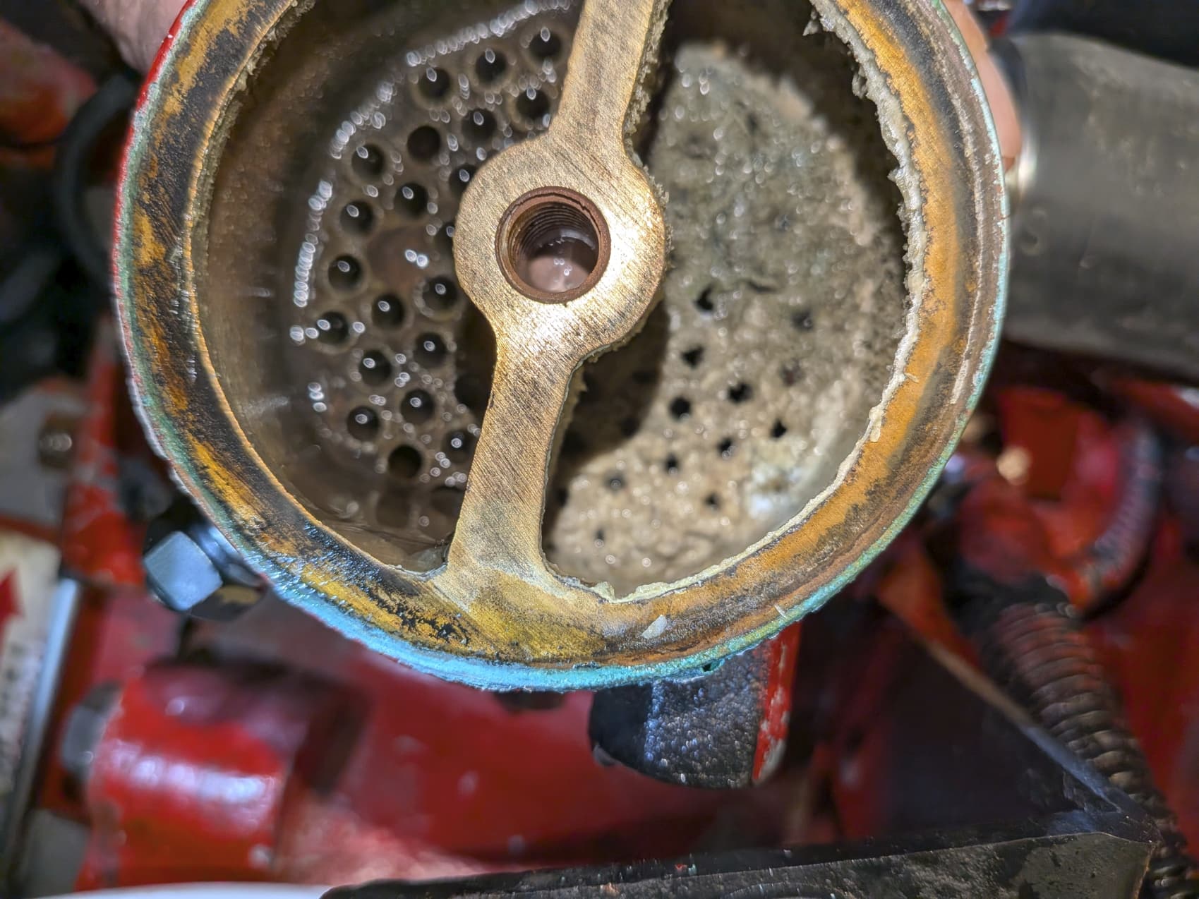

My heat exchanger was replaced with a brand new one 4 years ago, so I didn’t think it was the problem. But to be sure, I took one end cap off my heat exchanger, and bingo… one side was about 90% clogged with some calcium deposits that I suspect are barnacle related. Really surprised the engine didn’t run hotter given the amount of blockage.
I cleaned the tubes with a stainless welding rod, which is somewhat similar to a coat hanger if you’ve never seen one. Then cleaned out the debris and tube end with a 3M green scrub pad. A small mirror is very helpful when doing this as its pretty tough to see inside the end cap. After this I bought some Barnacle Buster, and ran a treatment using same method as I did with the Salt Away, again leaving it overnight.
After cleaning, before Barnacle Buster:
After Barnacle Buster:
The end cap and gasket were all in good shape so I didn’t have to replace them, but I do carry a spare set onboard just in case. I also would use a Dremel tool with a nylon brush attachment (Dremel 404-02 Nylon Bristle Brushes (2 Pack), 1/2 : Amazon.ca: Tools & Home Improvement) to clean the end area of the heat exchanger, but I didn’t have this Dremel attachment at the time, I do now.
After reconnecting the thru hull hose and running the engine to flush out the Barnacle Buster, the exhaust sound and water flow was back to normal. Checked the hoses and engine for leaks, especially the heat exchanger, all good.
One thing I wonder about is why are there only calcium/barnacles on one half of the heat exchanger end as shown in the photo? Anyone know?

What a great dissertation on your heat exchanger maintenance. I appreciated the views of what I will eventually need to do. In my view of these photos I would think of the difference between scaled or clean has to do with the temperature of the water on each side. I don’t know if the cold or hot water caused the scaling. Nice job.

Warmer side has more deposits.
Well now I know
