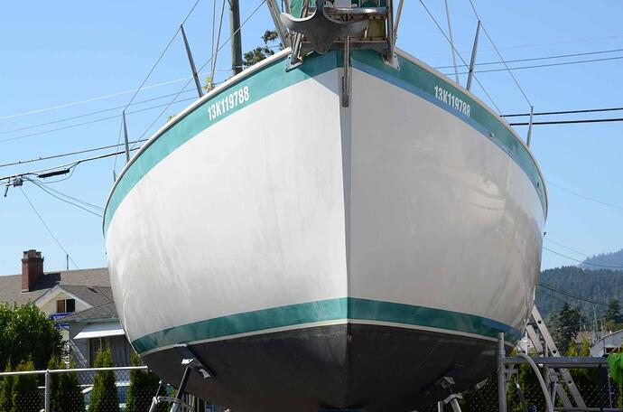

I am not trying to sell you anything but based on the photos you are dealing with a case of heavy oxidization. La Reina was oxidized but not as badly. She came up quite well, especially the white.
You will need a good quality polishing machine such as a 9" Makita with the appropriate bonnets/polishing pads. I have used 3M wool bonnets. Do not use an angle grinder, they spin at too high of a speed and could burn through the gelcoat. It is way too much work to do it by hand and you will give up before you have done enough. If you don’t want to purchase try renting.
I suggest you start with a heavy oxidization remover or rubbing compound after you have given her a really good clean. You will need to spend about 5 minutes doing each 2’x2’ area of the hull and keep the polisher moving. Do the blue sheer and boot stripes separately because the blue will come off onto the pad and then onto the white gel coat. Once you are done with the rubbing compound you switch bonnets and go to a polishing compound such as Finesse-11. When that is done switch bonnets and apply the wax (two coats). Collinite 885 Fleet wax gets good reviews. If you use the Collinite make sure you buff it off before it dries. Unlike other paste waxes you do not let it dry to a haze before removing. If it dries it takes a lot of effort to polish. I spent a full day (10 hours) doing the hull on La Reina. The first year she looked better, the second year she looked much better. Unfortunately the blue still fades and develops that grey oxidization look. About every two months I spend a couple of hours at anchor applying Meguiars One Step Cleaner and Wax to the sheer stripe.
The article I followed when polishing La Reina does not appear to be on line anymore.
If the oxidization remover does not work you might have to step it up to 800 grit sand paper. I have not been brave enough to do that. I am too worried about sanding through the gelcoat. If that fails or you don’t want to try the sand paper there are gelcoat restoration products such as Poliglow. Here is a a link to Practical Sailor’s review from 2008 practical-sailor-searches-for-the-best-gelcoat-restorer
Many of these are acrylic products not unlike Zep floor wax. A number of people have tried Zep because it is much less expensive than the gel coat restorers. I have not tried either but I have convinced my neighbour to let me use his Albacore racing dinghy as a test subject for the Zep.
Here are a couple of after shots of La Reina the second year I polished her.

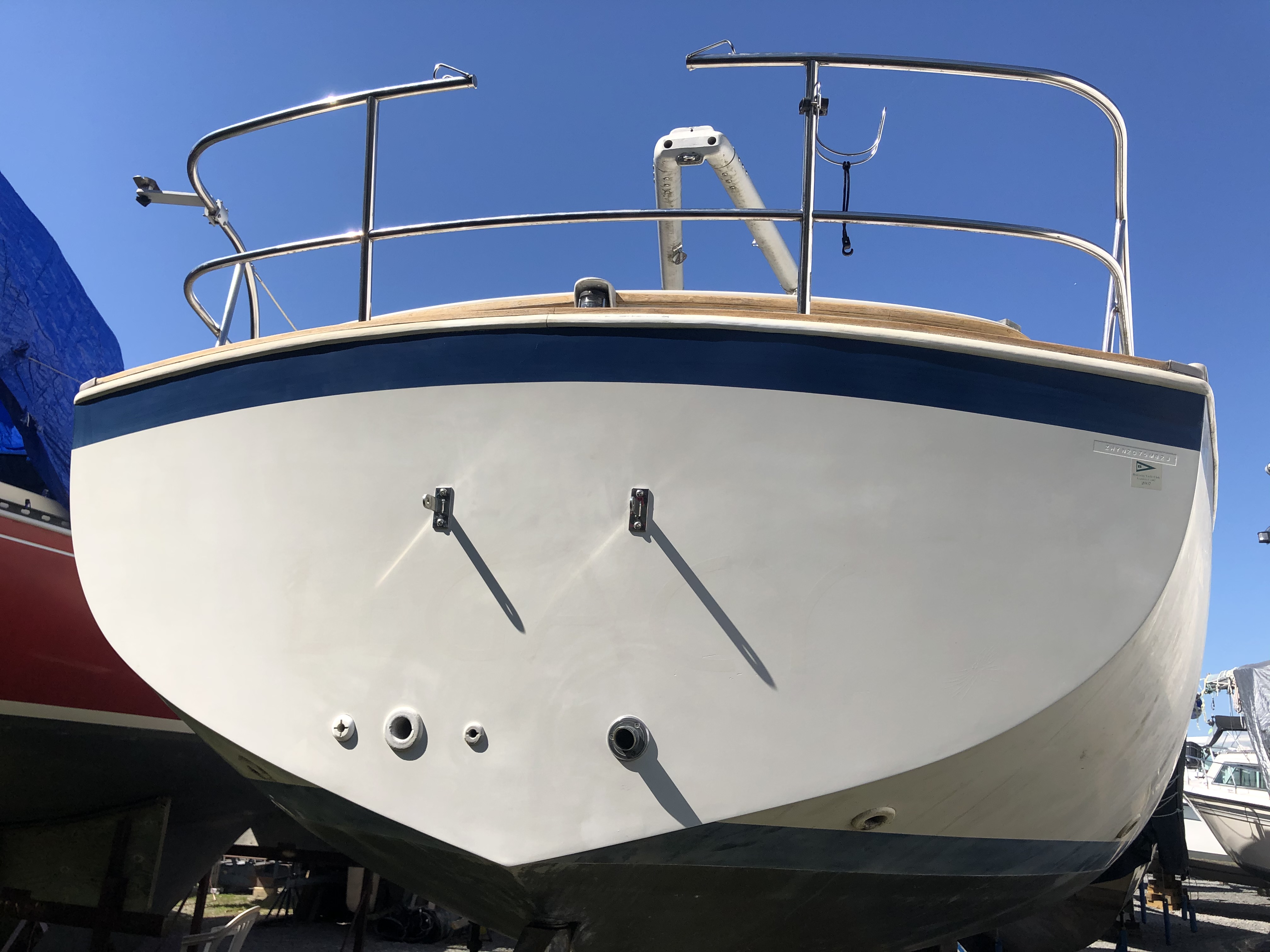

Here’s my first draft :slight_smile: Lots more to do
On Saturday, May 23, 2020 at 12:27:14 PM UTC-5, Peter Moodie wrote:Peter Moodie

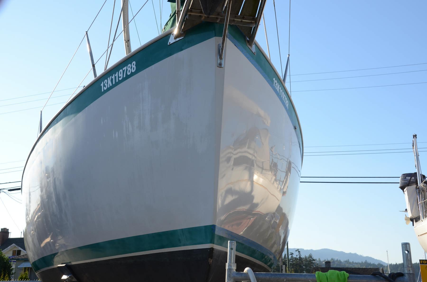

Hi again Val,
Here are two pictures from our compounding experience. I think the after picture is prior to waxing.
Wow, very encouraging to see what I will end up with. I’m pretty confident that it’s no worse off than yours and Mark’s hull. Can’t wait to see the final results!

Val:: I’d seriously consider replacing those through hulls. They look very sun dried and brittle. If they feel chalky, they are in danger of failing. The transom looks outstanding.
