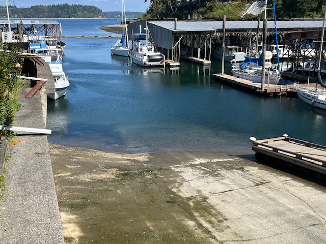

Here’s the dock I’ll be on (about 2 o’clock in the photo – the long empty dock. This taken at a minus tide). Photo taken facing north…IMG_3536.jpg
Hello,
If that was my slip and it doesn’t look like there would be any current. At least on Hippō i would:
Wind from north and east- drive in forward port to.. the stronger the east the harder the angle to the dock to drive the bow in and use the port kick to get the stern in.
Wind from south and west - reverse all the way in, Starboard to. Out in clear water get enough way to have control in reverse then back her all the way in. The wind will keep the bow under control. A shallower track if it’s more southern and a wider track for a harder west wind.

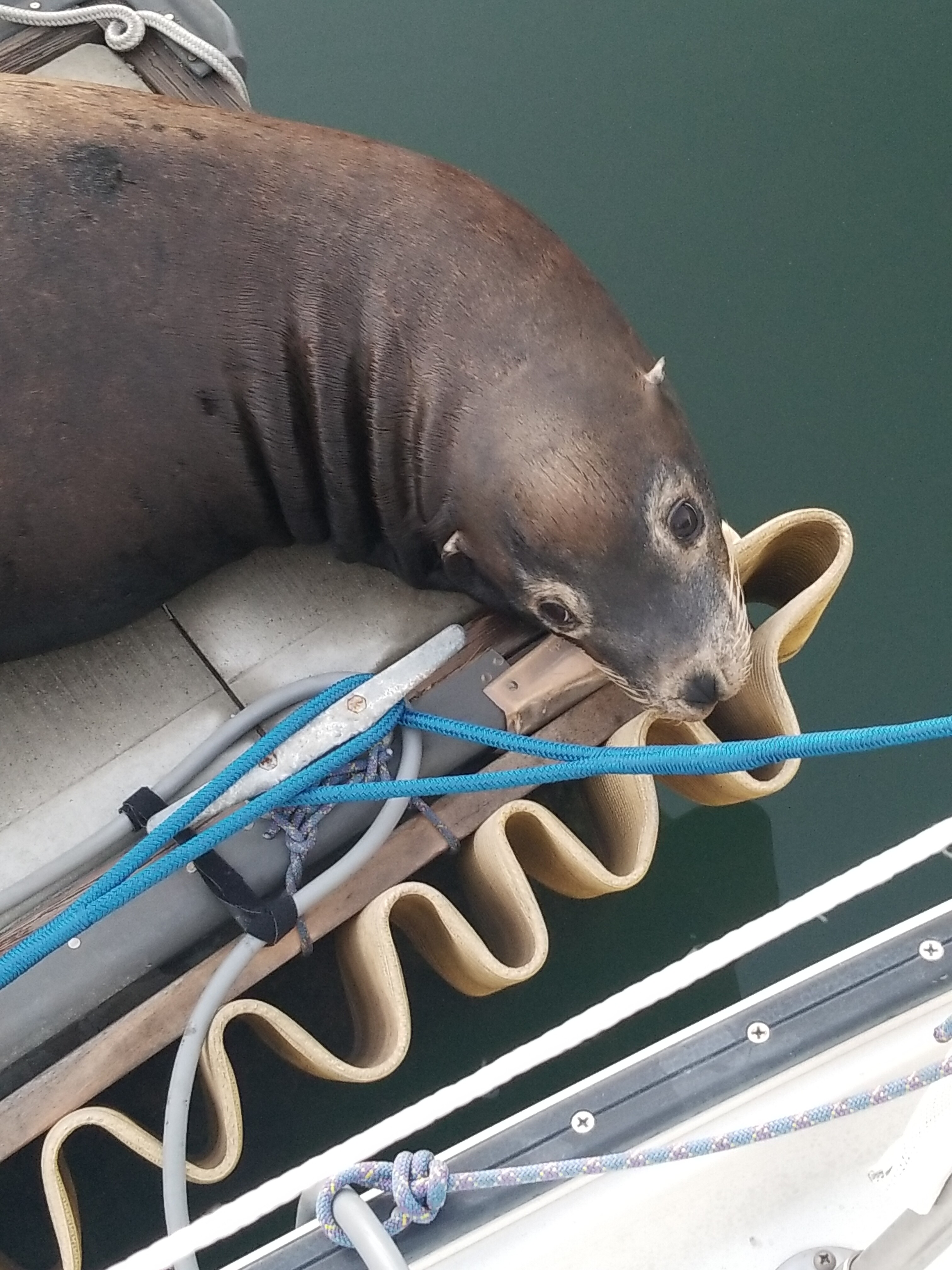

A number of docking and departure strategies for side-tie slips with crosswinds involve using a spring line, as others have described. Because many of those tricks involve pressing one part of the boat against the dock while another part angles out, fender placement becomes really critical. If your marina will let you, one way to ameliorate that is to have bumpers running the length of the dock. A cheap way to do that is to get used canvas-covered fire hose and line the entire dock with it in a scalloped pattern. Here’s a picture of that on my dock, with a local acquaintance admiring it.
Fire hose dock fender.jpgYou can often get the firehose free from a local fire department, or buy it from a site like https://www.repurposedmaterialsinc.com/?s=firehose&post_type=product&dgwt_wcas=1
