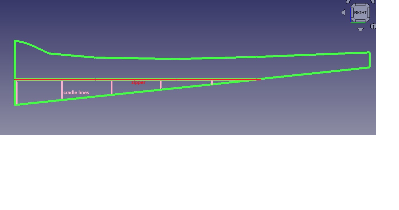

The sketch looks like this
The “bottom part” is the maindrop-part. It is there, where the sail weights the most. It is only 1/6th of the surface of a full stackpack. Zippers on both sides allow to take the “top-part” (sailcover) off. Where the zippers end, and the sailcovert continues, will be “closed” with tourniquet turners.
What are your thoughts? Is it the best of both worlds combined or have a made problems of both systems add up?

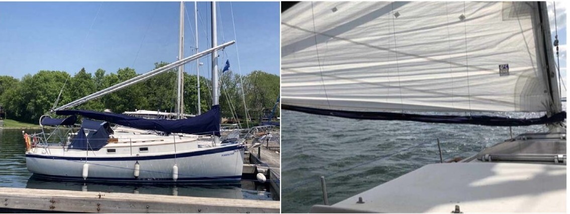

It sounds like a great idea. If I’m following your intent, it sounds very similar to a design that Butch Garren and several other Chesapeake Bay Nonsuch owners developed, as well as a similar design that Ted Eedson wrote up and posted on the INA website.
To see Ted’s, go to https://www.nonsuch.org/Members-tips-and-projects and look for “Nonsuch 26 Top Loading Sail Cover - Posted October 2020”. Here’s a pair of pictures lifted from his document which show how it looks on his boat at the dock and under sail:
I’ll send you the plans for the Chesapeake Bay design privately. It was originally done for N30’s, but it’s been scaled up and down. I’ve used that one with good results on both of my N26’s, Butch and the Chesapeake folks have had it for N30’s, and I helped my friend Phil scale it up for his N36. Here are some photos of that design that I got from Butch when I was getting ready to do mine:
I’m looking forward to hearing more about what you come up with. I’ll bet you come up with some really good improvements.

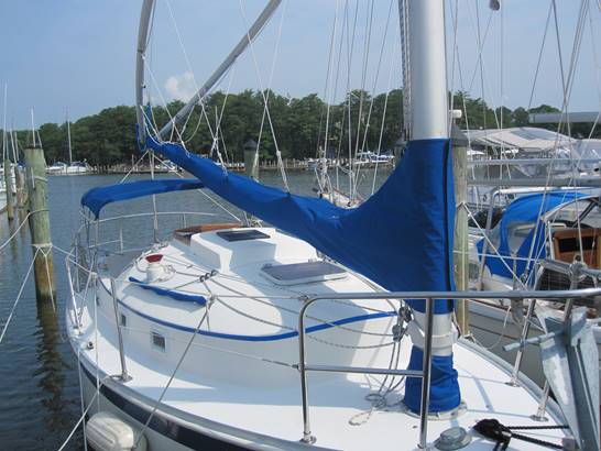

Yes, the sail cover material flapping around is not nice. When I bought Mistoffelees, 21 years ago, it come with a home made zip up sail cover that was built into the lazy jack lines attached to the wishbone. It was customized using the original sail cover material. The prior owner made the mast surrounding part a separate zip off piece that zips onto the rest of the hanging sail cover just aft of the mast. That small that goes around the mast is zipped off prior to sailing. Some people whose sail cover remains around the mast while sailing have found that the lose material often feeds into the turning block at the bottom of the mast. My version requires a bungee cord that goes around the mast and attaches to both sides of the sail cover pulling the thing straight & taught - no flapping around. The archives will some detailed postings of how to build your built in sail cover.
