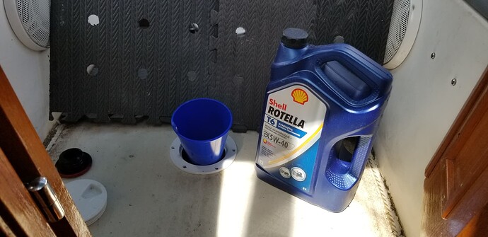

I was contemplating my first Oil change on Southpaw.
The oil fill is located under the cockpit sole.
There is only a few inches of overhead clearance to allow for filling.
This coupled with fiddling with a funnel and hose guaranteed a spill a minute.

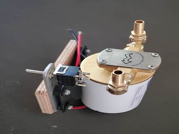

I would connect the present oil drain hose to a reversable pump.
It worked like a charm, not a drop was spilled and took less than 5 minutes.
  1. Put hose into empty container
  2. Support container with right hand
Hold switch down with left hand
More than one Gal pumped out in less than a minute
  1. Insert hose into clean oil container support as before
  2. Hold switch UP until sump is full
Test level on dip stick
I mounted the assembly on a small board.
This was so that it could be easily removed if required to work on engine.
It also made the actual job much easier.
The mounting board is 5/8” thick and just large enough for the pump
The switch mount is 1/8 x 1 x 5 ½, it also was in my might use someday locker.
I used fender washers under the other two pump mount feet 3 made a stack 1/8 thick
I reduced the pump to 3/8 and used 3/8 fuel hose, nice and flexible
The pump is taped for straight Pipe but tapered fittings with dope work just fine
Some day I’ll wire it but for now I use an extension cord for power
I used a snug metal plug to close the In/Out hose, cross drilled for hanging ring
I think I’ll add a 3/8” OD Metal or Plastic tube to reach bottom of a I gallon oil container
Reversing Switch $11.99 at Amazon
weideer Momentary Reverse Polarity Switch 12V 30A Motor Control RV Jack Switch DPDT 4 Pin (ON)-Off-(ON) Toggle Switch with Waterproof Cap Wires
Adapter available at Defender Industries as a 5 pack
I cut off one male leg and used these to facilate wiring the switch
Ancor Double Male-Female Adapter
Item:#1393803
Reversable Gear Pump $63.99 at Amazon
YaeMarine 12V 3.2GPM Oil Scavenge Pump Oil Pump Turbo Pump Impellor Gear Pump Self Priming Reversible for Diesel Lubricants Machinery Fuel Scavenge Oil Transfer (White)
