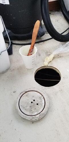

Last year when I changed my oil for the first time I added it about a half of a Gatorade bottle at a time at arms length. It took about an hour. Today thanks to someone this forum for the idea, (sorry, I don’t remember who) I installed a 4” deck plate in my cockpit sole. That took about 45 minutes and I now have access directly above the filler cap of my W33A. I had been putting this job off but it was oil change time and when all was done, it was very easy and not at all worth the procrastination.
If you have this situation (30U with V-drive) and have been fighting this job, do this. It is a great idea.
Thank you to whoever it was on the forum who mentioned it.

Sorry, I missed the best picture.
That was I, Paul. The first time I changed the oil I figured 45 minutes one time would save hours of future work. After 13 years, it adds up.

That looks like a measure twice drill once job.

Actually, you can just guesstimate the first hole. You get to adjust within 4 1/2”. I only cut a 4” hole with te hole saw so I could fine tune with a jigsaw.

Drill a pilot hole up from the bottom. Doesn’t matter if it is angled (for drill clearance) because you’ll soon be cutting it out!
If I could get a drill in easily I could have got an oil bottle in easily. Drilling from the top was fast and easy. I used a long bit that I could extend down to see what adjustment I needed.
I did have the same thought as you originally but it wasn’t practical.
