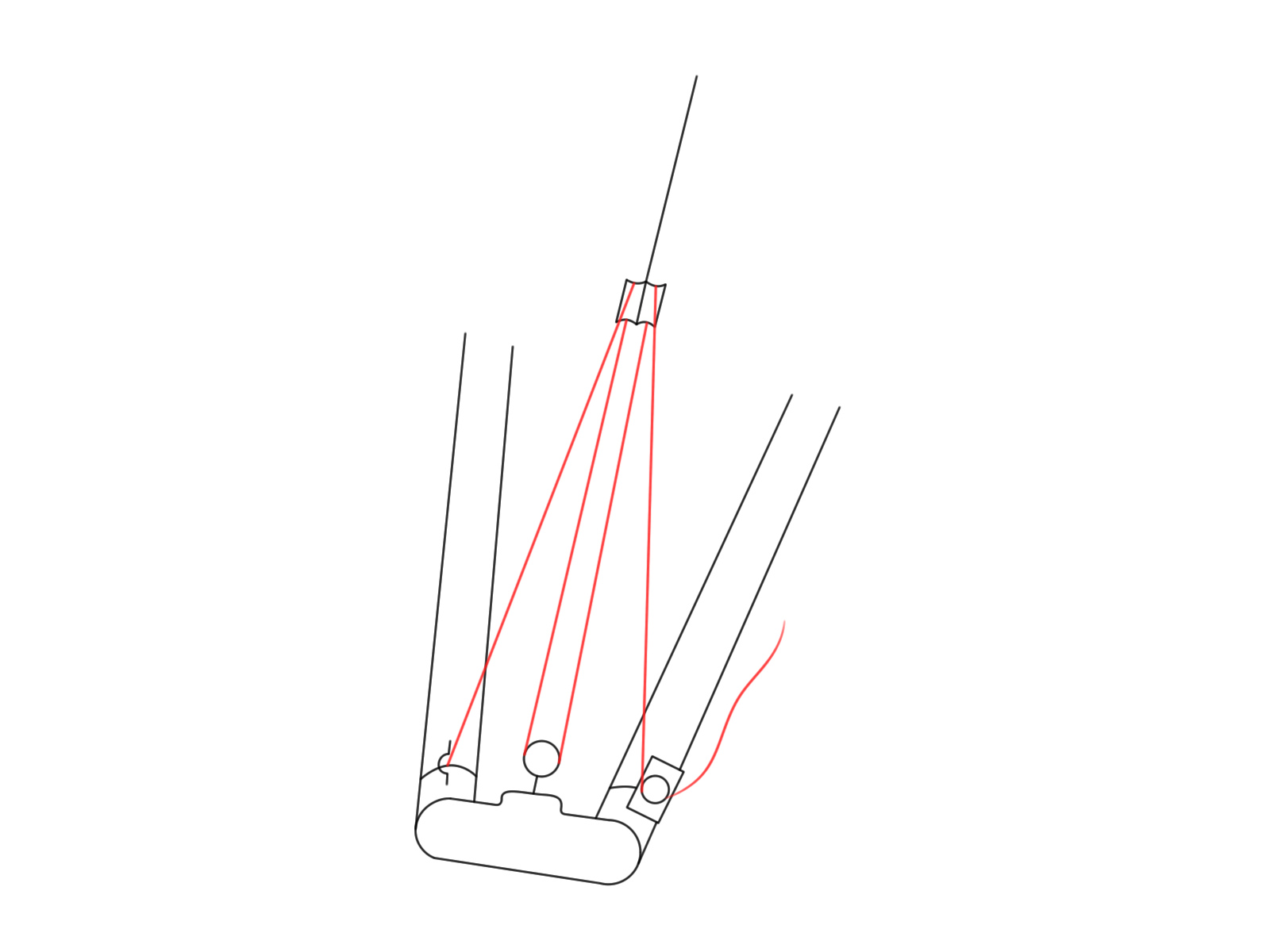

I’m opening up this older thread on our topping lifts for an update. Before Christmas I was looking at the best way to convert my fixed TL to adjustable and it was good to have some input from other owners. One of my concerns was how a tackle with a pair of double blocks under variable and sometimes no load can get badly twisted so I was exploring an idea to put the tackle between the deck and wishbone by the mast, rather than above the aft end of the wishbone where it is hard to get at. Since my recent phone consult with Mike Quill I have decided how to proceed. Mike suggested a way to rig the topping lift in the usual postion, but so it won’t twist. I have attached his diagram here, with his permission.
As you can see, the adjustable tether is dead-ended on the port side of wishbone aft casting to an eyestrap. It runs through double blocks at bottom of the fixed TL wire, and at the aft end of boom (on existing TL connecting ring), and a single cheek block bolted into the starboard aft casting of wishbone. This rig should not twist. Other info Mike provided: 41’ length (Nonsuch 26) for the fixed topping lift from masthead (I will probably make it a bit shorter, as discussed earlier, for some leeway when setting reefs). The 3/8" tether is calculated at 65’ but I will measure in place before cutting and splicing the terminal eye. I will add 4 or 5 eye straps along the starboard wishbone tube to manage the TL tether going forward. The length for the safety line will be determined once this is all set up and I think easily made with eyesplices in Amsteel or similar cordage.

Thanks Captain,
I will try that when I commission in the spring.
I’m wondering if it being tied off on the port boom would affect the position of the Tl so as you would notice at all when changing tack or jibe?
