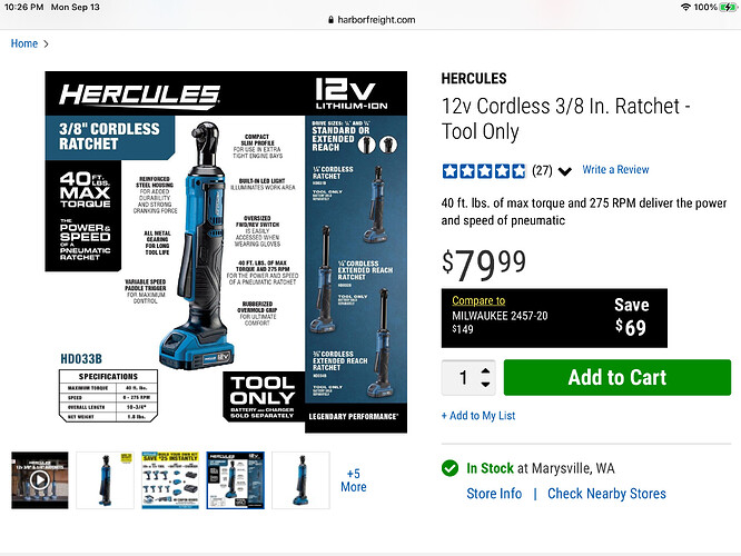

Would this be up to the job of sail raising?
Would need 3/8” to 1/2” adaptor, but very light both financially and physically.

Boy, this topic has a half-life of 90,000 years !!
Dick - Joe is bang-on. Much has been written about many, many drills that might (or might not) raise a sail. Obviously, it’s all about torque. Two-speed winches help a LOT. The Winchrite, mentioned above, puts out around 80 ft.lb which seems to be the benchmark needed to raise a sail. You’ll note that Ross said that it has trouble getting the sail on an NS26 to the top.
My little Hilti drill puts out 110 ft. lbs. It sure gets my buddy’s NS26 sail to the top. It gets my (still new and stiff) NS22 to the top VERY quickly. Personally, I don’t like the Winchrite as I question the build quality, the quality of the “mystery meat” components and the really problematic “repair scheme”.
I suggest buying a good name brand 1/2" drill that puts out a minimum 80 ft. lbs. Anything less will bring tears …
As I stated on this list some years ago, I have used a Sears 29v drill for some years, it came in a kit for$99 US, works fine, requires their 12v input charger, is rather clumsy and heavy and
has torque overkill with lubed bronze sliders. Since I use the Cunningham to tighten the luff anyway, it occurred to me that the powered ratchet might work. I have no experience of such device durability.
NS26c, #35
Swoose.
Richard Lane
Port Townsend
Dick
Looks like it should work fine. I currently still use my Sears drill with 400 inch pounds of torque which is equivalent to 33 foot pounds of torque. It raises my NS 30U sail with no problem. The only thing I wonder about how you would adapt the Winch Bit to the rachet since it does not have an adjustable chuck like my drill does.
