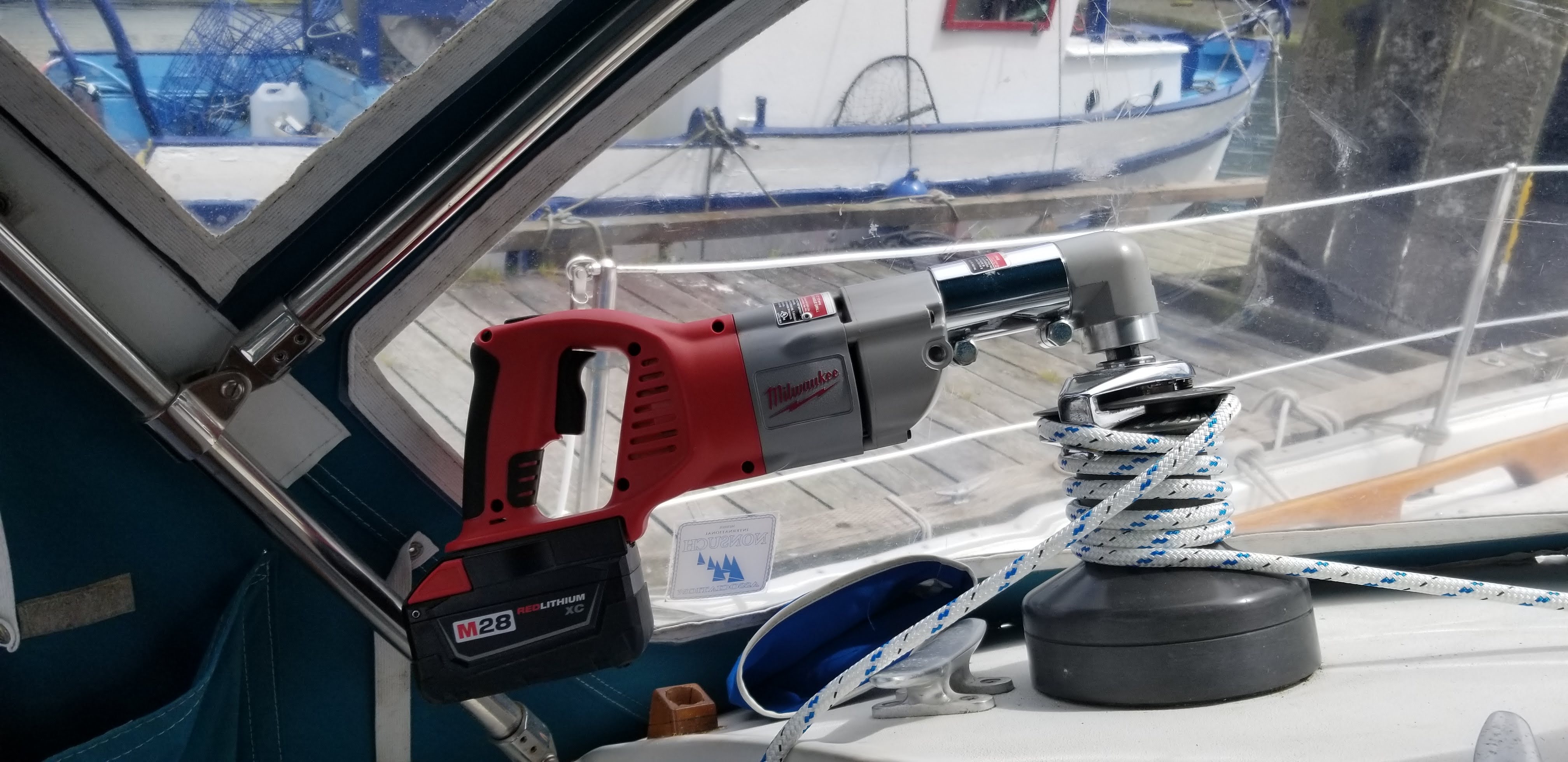

Plus one what Ernie said. My Milwaukee 28v runs my sail up in about 20 seconds with no work on my part. I also use it to easily sheet my sail under full press of wind.
