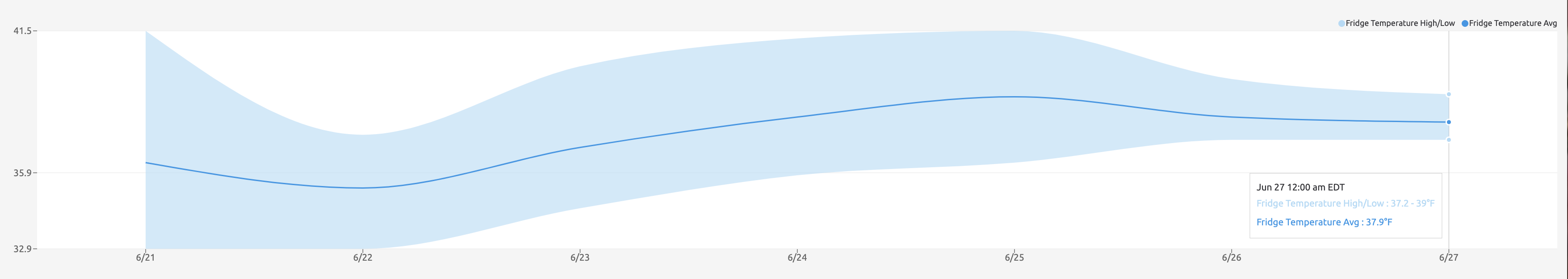

  3. Soave’s fridge struggled to cool to 38ºF. Below is a graph of the last 7 days. 24th and 25th outside temps were 100 or so during the day. Yea, I’m a nutso data guy… probably the only boat in the basin with live monitors running 24x7. Screenshot 2025-06-28 at 5.49.20 PM.png
