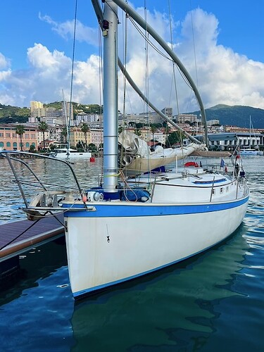

Hello, I have been sailing in Corsica (Mediterranean Sea) for 2 months to discover my new Nonsuch 30 Ultra. I am going to do a big refit before having the project in 2025 a tour of the Mediterranean then in 2026 a crossing of the Atlantic. So I’m going to have a lot of questions to help me make my choices. The boat was called Noradipula and has now been renamed Karibu.
My projects: 1 new sail, new companionway hood and bimini, overhaul of the mast with a new rail

Congratulations on your new Nonsuch, Philippe. I hope you are enjoying her. I’d love to see a photo if you have one.
