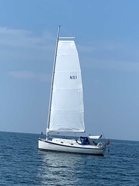

On my 26 I chose two sets of reefing points 10’ apart. This served me well on Lake Ontario. I only used the double reef once when the breeze was registering 30 to 40 knots. It was the day of the RCYC’s Commodore’s cruise at the end of the season. The sailing office prudently cancelled the cruise as there were many new members with large boats and little experience who might have attempted to go out. Several J105s ventured out along with Pondus a 26 and myself. We both took in a second reef prior to venturing out. In those conditions, the boats were perfectly balanced for the first time so we enjoyed light steering. We both had great sails while single handed. One of the J 105’s broke its boom when the boom vang was not released in time. It was the experience of having the boat well balanced for the first time to decide that I needed to change the rig to reduce the foot by 5’ to enjoy sailing in my twilight years. I am convinced that the leaks that appear at the rudder post can be attributed to the pronounce weather helm and the forces it generates at the entry into the hull.
Since the wishbone rig requires an outboard and inboard pennant for each reef, things get cluttered even with two reefs. Three would be too much for me. I get by comfortably with a single pennant for each reef which is simple to set. A photo of Mascouche participating in the 2014 Rendezvous with a Botts sail can be seen on the cover of the Kwasind September/October 2014 issue. I am enclosing a photo of her with a standing gaff in light weather and 30C heat. The sail was made and designed by Durk Steigenga (ex Performance Sails) of Halifax. As he is local, you would do well to approach him even though he is retired. He participated in this year Bermuda Race and is a volunteer for the Chester Schooner races.
Mascouche NS c#1
