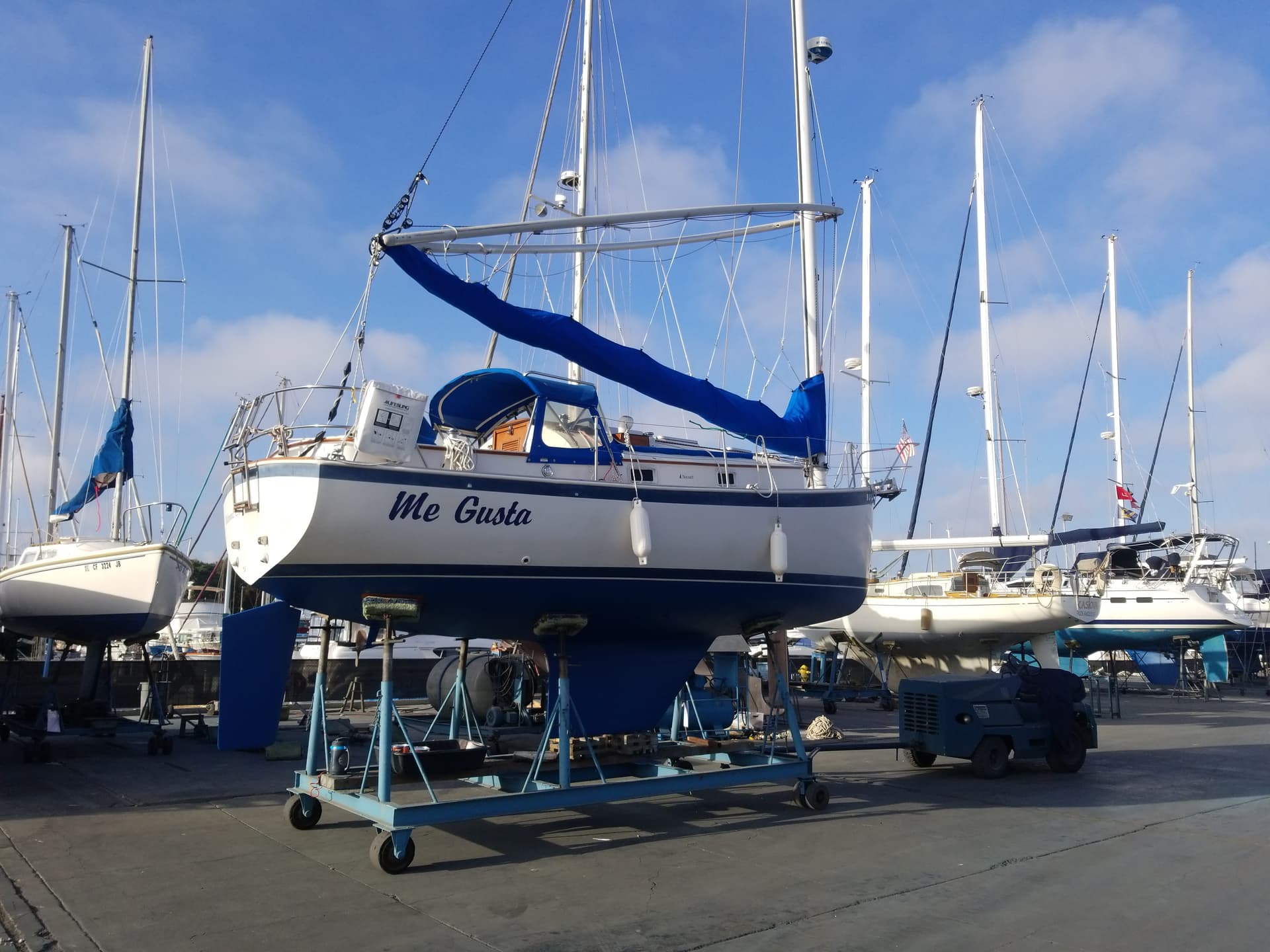

The theoretical hull speed is an approximation based on a displacement boat that sits in the water. Planing hulls (e.g., a Laser or a racing shell) that sit on the water can do a lot better.
Semi-displacement hulls have the potential to get out of the water and plane under the right condition. I suspect that, because of the design influence of Finns and Lasers, Nonsuches may have some element of that DNA.
Here’s a picture of my boat at a rare point where it was clean and shiny. I think it shows how the hull shape could give our boats a fighting chance of doing a bit better than the theoretical limit.

Laser does plane, but a racing shell is most definitely and 100% displacement. To Paul’s statement: it just generates such a small bow wave that it is easy for even human muscle to climb over it, or punch through it, however it actually goes I am not sure.
