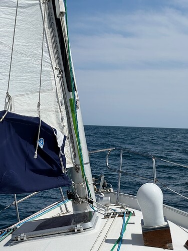

Peter, your mast looks very different from my 30U number 283, where the tack and collar are bolted ( see picture ). Is one method better than the other?
