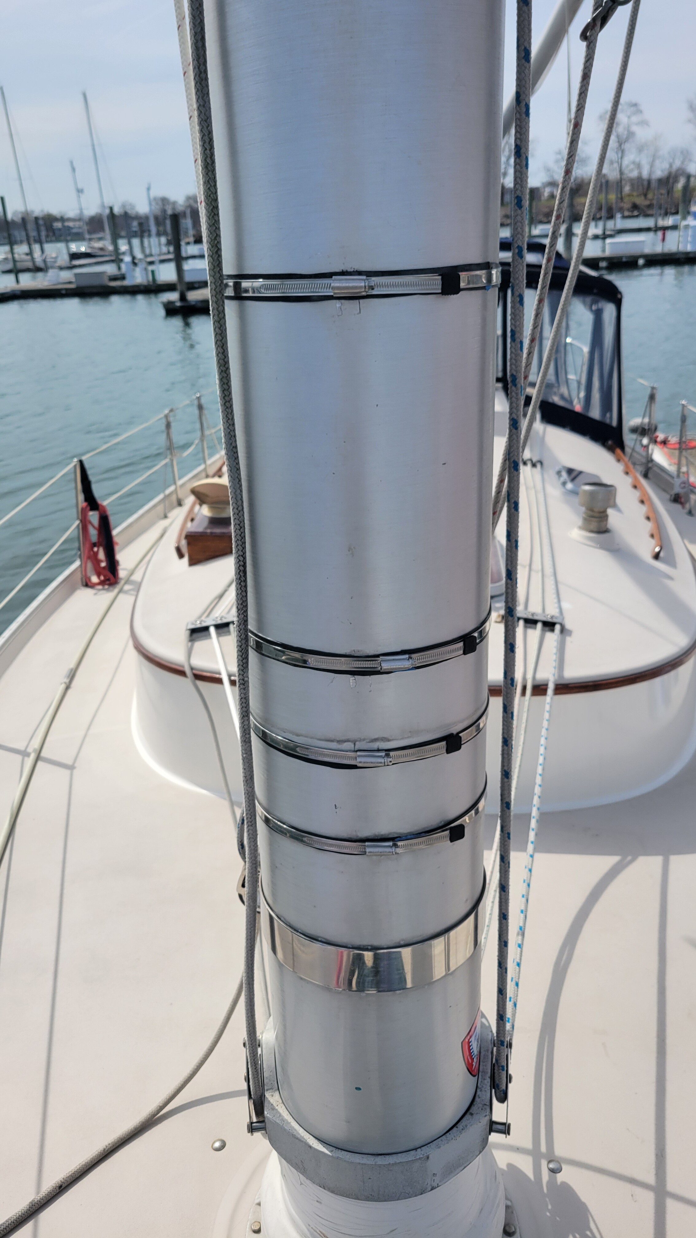

Hi All,
While prepping the boat for Spring, I noticed that the material (rubber?) beneath the stainless steel straps that hold the aluminum plate in place (to which the lower end of the sail track is attached.) has lived well past it’s expectancy, and needs to be replaced.
I am assuming that the material is rubber and serves to insulate the stainless steel bands from the aluminum mast. Please correct me if this is wrong…
Does anybody have a source for this material in the US? I would reach out to Mike Quill as he is always very helpful, but importing from Canada is becoming more expensive by the minute.
Specs?
thickness, width (I should have measured, apologies)? Figuring to replace the material under all of the bands as it is 38 years old.
If you zoom in on the photo you can see some of the material hanging down below one of the bands.
Thank you,
Jersey City (weeks away from moving the boat to Stamford, CT!)

You definitely want to keep that rubber in good shape. Or more to the point, you really want to keep the stainless bands from contacting your aluminum mast. I know this from painful experience as I went through a lot of work recovering from some corrosion where these small bands and the larger tack collar had been in contact with the mast for too long.
I used these high quality 316 stainless bands. (Measure your mast to get the right ones as you don’t want a lot of extra):
https://www.fisheriessupply.com/scandvik-316-ss-solid-band-hose-clamps/13628
And I separated them from the mast with strips of this neoprene sheeting (use the 70A durometer hardness):
https://www.mcmaster.com/catalog/131/4072/9013K42
I used a piece of scrap plywood and a 3’ straightedge to cut the neoprene into strips with a snap-blade knife. With a little practice and patience you can cut a very straight line this way. I cut them just slightly wider than the clamps so they wouldn’t look stupid. I think I cut them 1/16" oversize, but I’m not sure. In retrospect, I could have cut them a bit wider and it would still have looked fine, so experiment with how wide you want them before committing to a bunch of cutting.
When placing them, I first measured and cut the strips to length. Then I put the clamps on loosely and slid the rubber under them. You have to fiddle with band tension and such but it’s really easy to get the hang of. There is a point of adjustment where the clamp will hold the rubber but you can still fudge it up or down. At that point you get it all even all the way around and then finish clamping. Buy using adjustable clamps it is really easy to do this and also to correct if you get it wrong. It was one of the easiest parts of the whole mast project.

Removed the four old mast clamps this past weekend, and replaced with four new clamps and rubber strips to isolate the 316L Stainless clamps from the aluminum mast.
Luckily, where the rubber on the old clamps had failed and the clamps loosened, upon close inspection there was no damage to the mast, only dirt that wiped away, so the old clamps could not have been loose for very long.
I purchased a 1ft long by 36 inch wide (that was the minimum width) piece of 70A durometer hardness neoprene sheet from McMaster-Carr, and cut strips that were slightly wider than the new clamps, and trimmed the 36" strip length to fit the mast circumference (about 32 inches for the 30U mast). I purchased a 5 pack (only needed 4, but now have a spare) of SAE 170 worm gear hose clamps in 316L stainless from PYI. These came with ‘clamp jackets’ to cover the ends and protect fingers (and eyes - years ago I sliced a cornea on the protruding end of the mast-boot clamp, not good).
All went smoothly, including how to remove the two clamps that didn’t have worm gear drives, but where the end was folded over and secured by tabs. I was going to add the 5th clamp in the space between the top clamp and the next lower clamp but the neoprene strip and clamp together would not fit through the opening between the mast track and that backing/reinforcement plate… I figured if it has been fine for 38 years with four clamps, it should be okay…
A couple of photos of the finished project:
