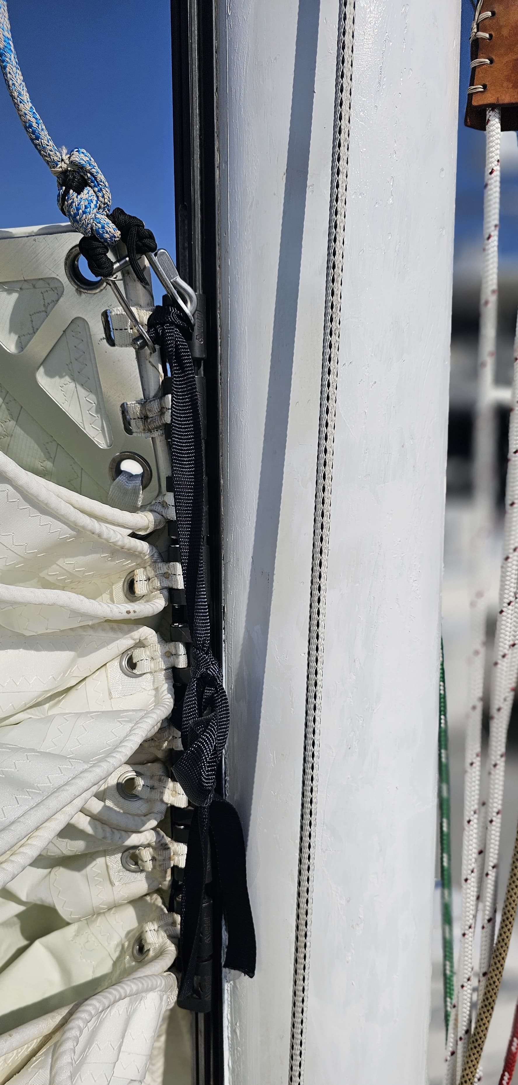

When getting the sail slides back on the track, there’s the problem that gravity makes them want to fall right back down the track. Since I was working solo on fighting this, I tied a piece of webbing to my halyard shackle so that a long end hung down one side of the sails, and a short end with a loop hung from the other. I adjusted the halyard to slightly above a spot that would provide room for all the slides. When fighting the weight of the slides got hard, I pulled the long end around underneath the slides, put it through the loop to give me leverage, pulled them up and tied off the webbing with a slip knot. Then I’d work a few more slides up, pull the slip knot and move the webbing to include those new slides, and repeat until done.

I had my sail off three times last spring. Twice I had help, but the third time I was on my own. My sail is really heavy and I’d been using the halyard to get it off and on the boat, so it was an easy leap to having it help with putting the sail back onto the track. Yes, it does work very well, even if a bit slow.
