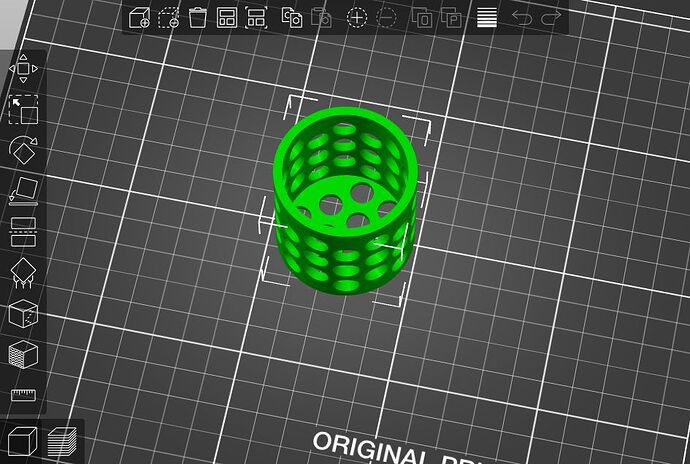

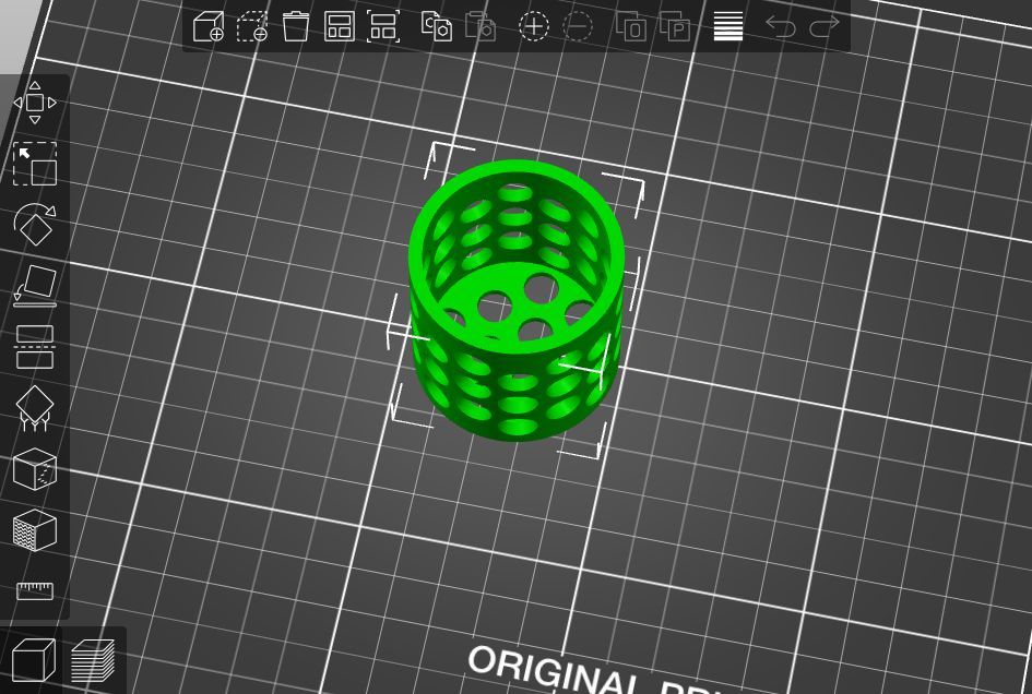

First up “Drain Caps”
These are designed to fit drains where the original screen has a diameter of 47 mm (1.85").
The cap itself is modeled at 46.8 mm (1.84") for a snug fit.
On my boat, these are the drains along the side decks.
If your drains are a different size — or if you’d like a version for the cockpit drains instead — just let me know and I’ll adjust the model for you.
The design was created in FreeCAD, and the included file is ready for your 3D printer’s slicer.
If you’re using different software to edit or print the model, tell me what format you prefer and I’ll see if FreeCAD can export it for you.
FreeCad file:
draincap.FCStd (620.1 KB)
3MF file for your slicer software:
draincap.3mf (336.5 KB)
how it should look in your slicer:

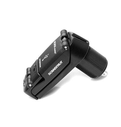

Next up: Mount for the Scanstrut SC-USB Chargers
These are waterproof high current USB chargers made for outdoor use.
I use one on my pedestal to power my navigation iPad — it’s a great product, but it’s meant to be partially recessed during installation.
Here’s a link to the product: Scanstrut SC-USB-03
The less expensive SC-USB-02 should fit as well.

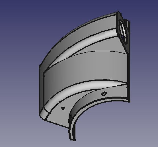

On most pedestals there isn’t enough room inside, and the required hole is quite large.
So I designed a 3D-printed housing that mounts on the outside of the pedestal, cleanly and securely — no big holes required.
One side holds the Scanstrut USB charger, and the other side fits a 12 V “cigarette lighter” style socket.
My pedestal is a classic Edson, with a 102 mm (4.0") column diameter, and the mount is designed to match that curvature perfectly.
It looks super slick, keeps the installation fully weatherproof, and makes both power options easily accessible at the helm.
Freecad file:
scanstrut_pedestal.FCStd (963.3 KB)
3mf file for your slicer:
scanstrut_pedestal.3mf (303.2 KB)
