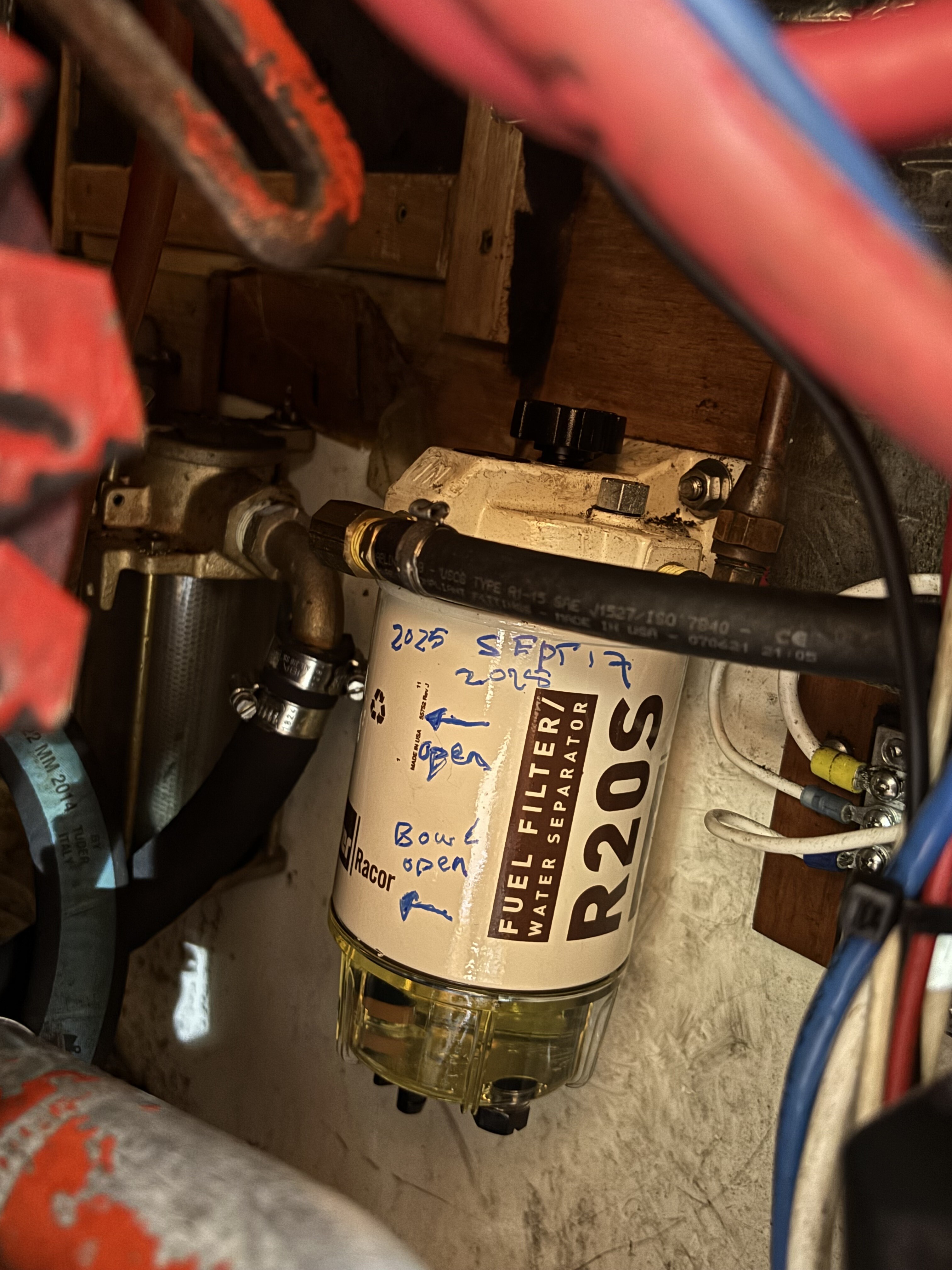

Here is my photos
I only have a O ring between the bowl and the racor filter elements
I filled up the racor to 75% only . Maybe I go to fill up to 100% this time
I also changed the other 2 filters … will try to tighten and make sure the O rings there are good too
See photos
Thanks
Shirley
Shirley,
Yes, it is the O ring between the bowl and the racor filter. Please check to see if it is properly secured in the groove within the bowl.

Shirley: Do you have a photo that is not co close in??

Yes I fired it many times… it struggled but at the end, it started. It is only when I lower to 2000rpm from 4000rpm (full throttle) that it dies out . I am waiting for my Racor bowl next Monday and hope this can resolve
There is a leak in the racor bowl seal when the electric fuel pumps operate . No leak when it stops . So I guess the non-brand bowl cannot handle the pressure

The problem was my “electric fuel pump” not working properly and the air was still trapped inside the fuel system. I discovered there is a manual pump on top of my racor fuel/water separator unit. See photo attached. I opened the air vent (the silver nut valve), opened the black knob and pulled it up. I started pumping until I hear no more air bubble coming from the primary filter. I did not open any “bleed nuts”…I only “listened” until no air bubble “noise”
BIG LESSON LEARNT! Sometimes, we really cannot rely on the electric fuel pump…it keeps making click click click but in reality, it isn’t pumping any fuel out!
