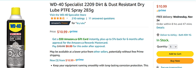

Hi all,
A shot of this on the mast track cars each time we go out seems to keep everything dry, clean and slippery. Oh, easy to get and cheap too.
